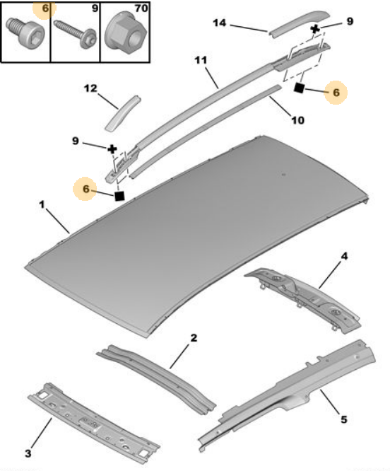

Hi Steve
If you look at the parts diagram,you will see that there are bolts (6) to hold these on, but the nuts (70) are not shown here - so I can't tell if these just screw into the supporting structure underneath or whether there are nuts on the inside. I've put up the roof bar removal guide - and again, this makes no mention of nuts anywhere, so maybe the bolts screw directly into the underlying support....

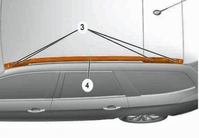

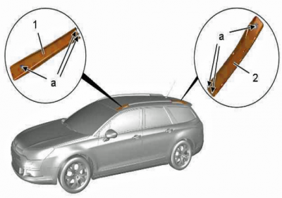

| Unclip: The roof bar trims (1), (2) ( as "a") using trim removal tools. Remove: The roof bar trims (1), (2). | Remove: The bolts (3) The roof bar (4) (Left hand ) |
Refit:
- The roof bar (4) (Left hand )
- Tighten to 0.8 ± 0.3 daN.m
- The roof bar trims (1), (2)
- Clip: The roof bar trims (1), (2) ( as "a").

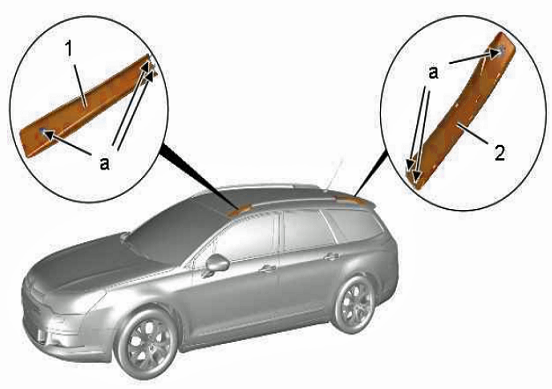

The plastic caps at either end just prise off using a trim tool, revealing some 6 mm bolts holding the rails to the roof after removing the bolts the rails can then be removed from the car
No work is required inside the car.
