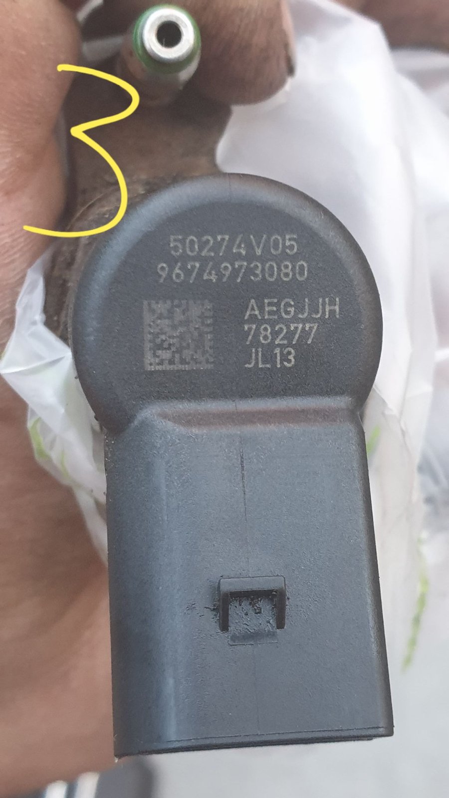

I have a 2011 3008 1.6 hdi which recently has been causing me problems going into limp mode i do have an ebay scan tool box its the WOW version i think its the same a the delphi one anyway i plugged it in and it come up with injector cylinder 3 and a load of abs codes which i think only got activated because the car went into limp mode because of the injector so what i have done is removed injector from cylinder 3 and swapped with cylinder 2 just to see if the fault code jumps to number 2 and yes it did so now im looking for a cheap injector to replace injector 3 now whilst i had the scan tool connected i had a look to see if a can re code the injector when i get it but this was not supported on the scan tool i have so im unsure whether or not these injectors need to be coded or you can just install them and job done?

Hi Marc thanks for having a look for me i think the one you are after is the one in the windscreen its VF3**************[VIN obfuscated, can be read by forum staff] i have attached a pic of the windscreen number the one in the door also the injector itself.GiveMeABreak wrote: 31 May 2020, 13:57 I suspect they 99% do need coding, but pop your VIN up and I'll check for sure.

Yes, these need coding and just for reference, it's the 6 characters on these that are the code - in the example above: AEGJJH.
Most diagnostic readers are just readers and may be able to clear the fault codes, but can't perform much more than that. Ideally, you'll need a Lexia kit with Diagbox to do this.
