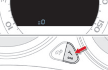

I assume you are talking about engine oil as you've mentioned the filter - no, you can reset the service counter yourself - it's in the manual and you don't need Diagbox - unless you are talking about the Auto gearbox oil?
Be aware though depending on your vehicle, other operations are expected to be checked like the Adblue (if fitted). But to reset if you don't have the manual or can't be bothered to read it is:
- Switch off the ignition,
- Press and hold the ".../000" trip distance recorder zero reset button,
- Switch on the ignition; the distance recorder display begins a countdown,
- When the screen indicates "=/0" and the spanner disappears, release the button.
