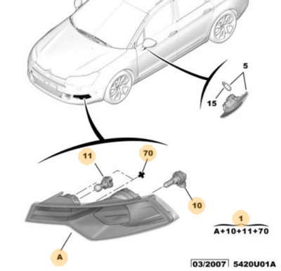

If it's the fog light assembly, then (for your VIN ending 926):
6208 J4 for the Left hand side
6206 J4 for the Right hand side.

Yes Marc thats the one thanks for that.
That looks like it needs fixing from behind so bumper off ??
Seen various price ranges of 6206 J4 is it worth just getting one from main dealers, it should be the correct one fingers crossed.
And yes got very lucky, the old girl took the hit very well all things considered.

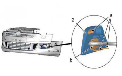

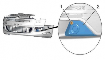

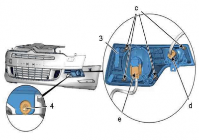

No, you can replace these easier enough with bumper in place. I had water ingress in one fog lamp that I replaced - and now water has got into the other so will need to do that at some point. Here's the instructions - angle them out is the easiest way with some flat plastic trim removal tools where stated:
Remove: The proximity sensor support (2) bolt (1).
Unclip - Detach: The proximity sensor mounting (2) ( as "a") using trim tools.
Disconnect the connector ( as "b").
Remove: The bracket (Proximity sensor) (2).
Remove bolts (4).
Unclip - Detach: The front fog lamp and front direction indicator (3) assembly ( as "c") using trim tools.
Disconnect the connectors ( as "d", "e").
Remove: The front fog lamp and front direction indicator (3) assembly.
