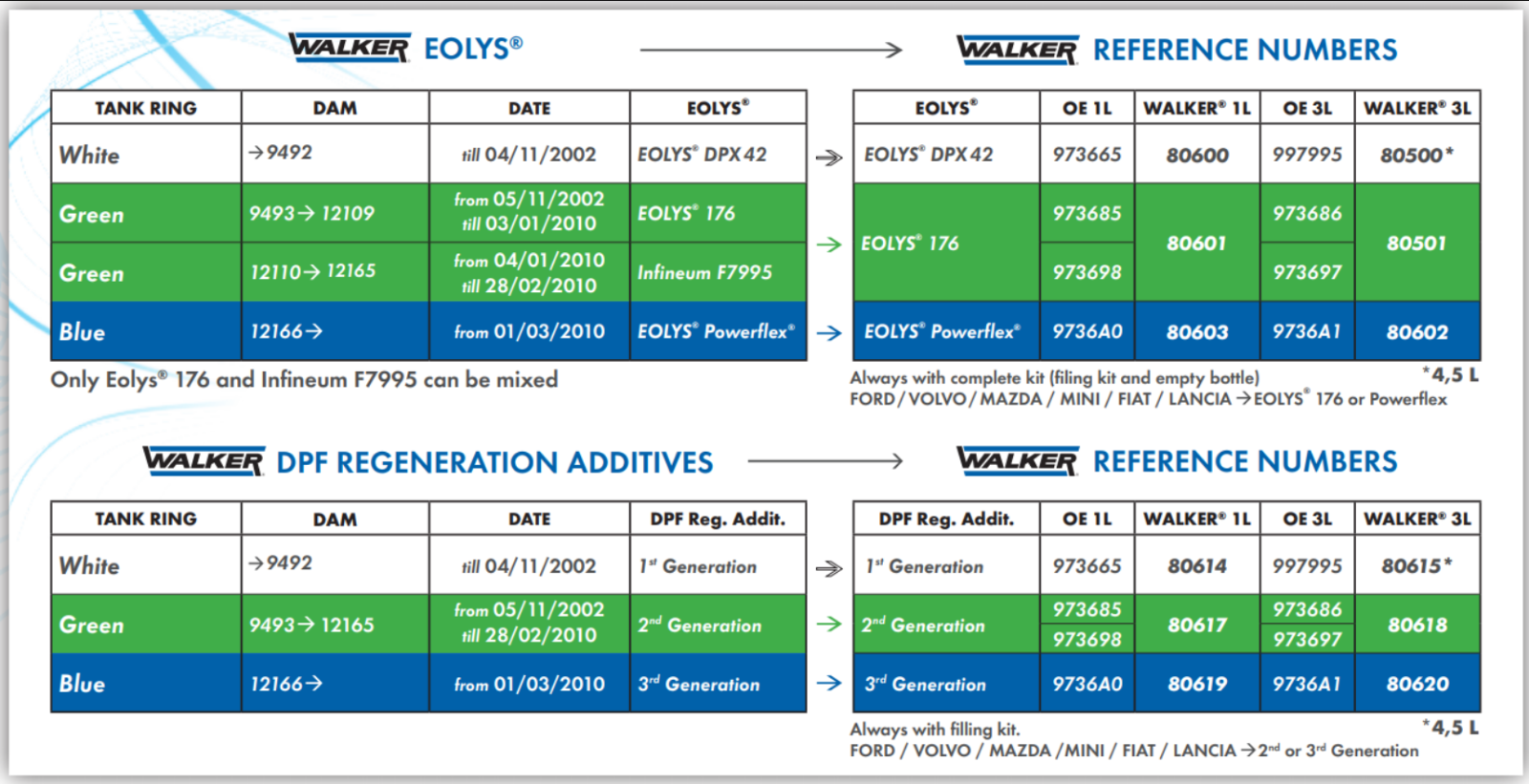

Your Build date is 11033, so that means your C4 takes Eolys 176. As supplies of this have probably run out the replacement is Infineum F7995, which are the only 2 types of additive that can be mixed. So look for Infineum F7995. Your tank should have the green click fit connectors, but regardless, this is the additive you need.

No worries - click on the table above to magnify it and you'll see walker equivalent products against the OEM parts references.
