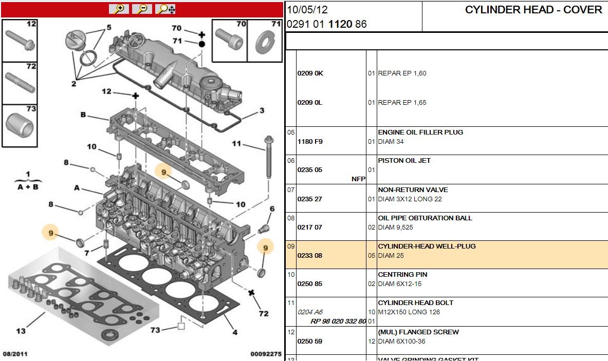

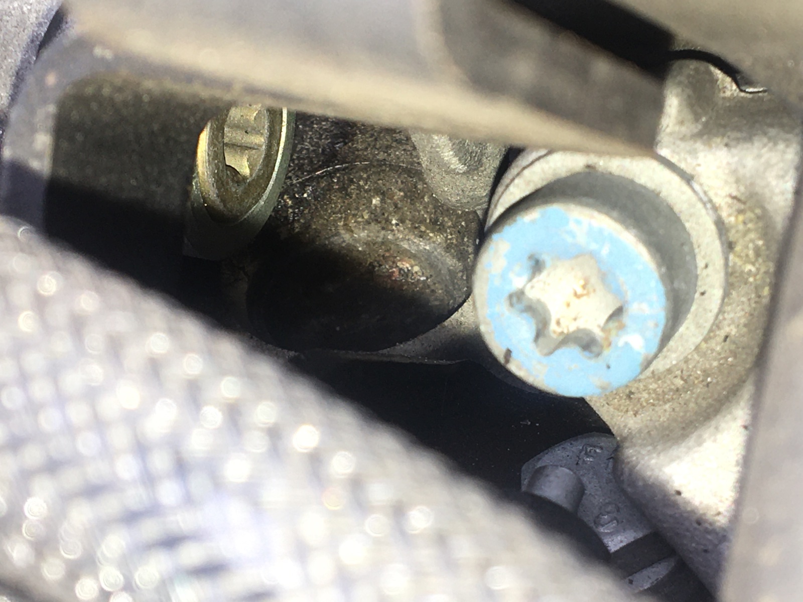

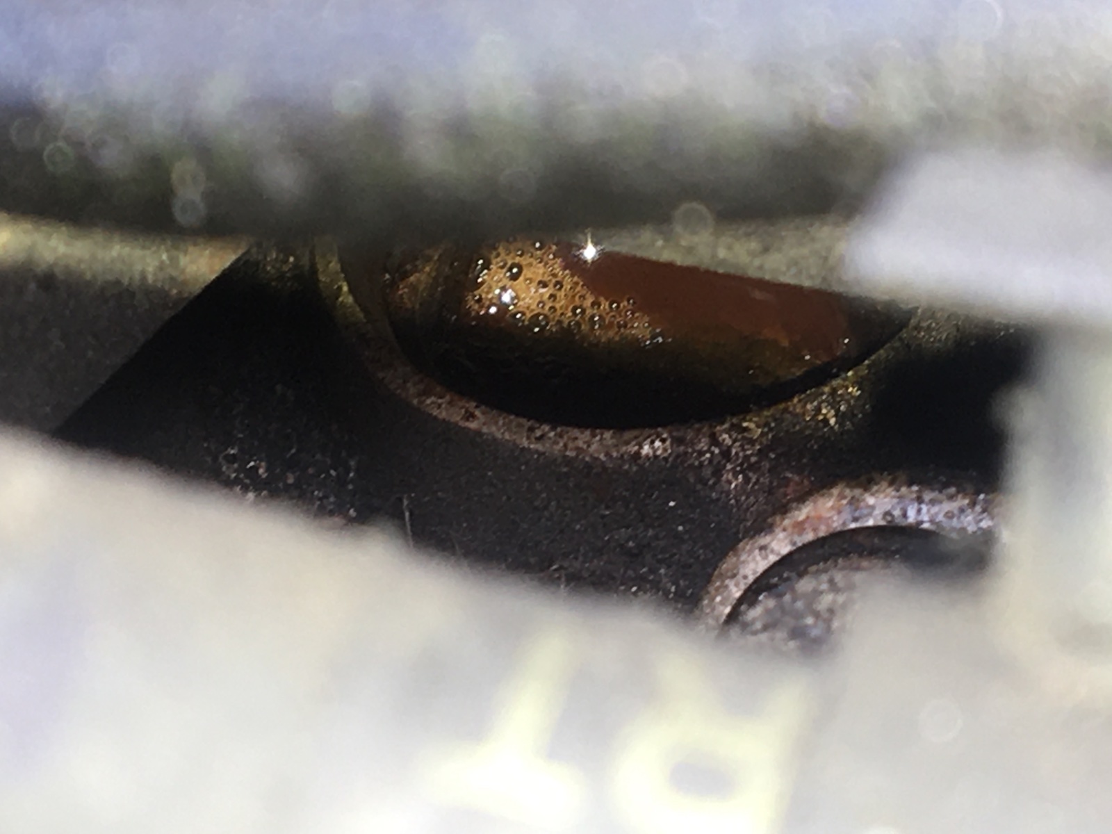

Upper smaller cylinder head CORE PLUG
Available as a single?
Got a small video but can’t load it ?
Part number please ?
Parts No request - Xantia HDi CORE PLUG

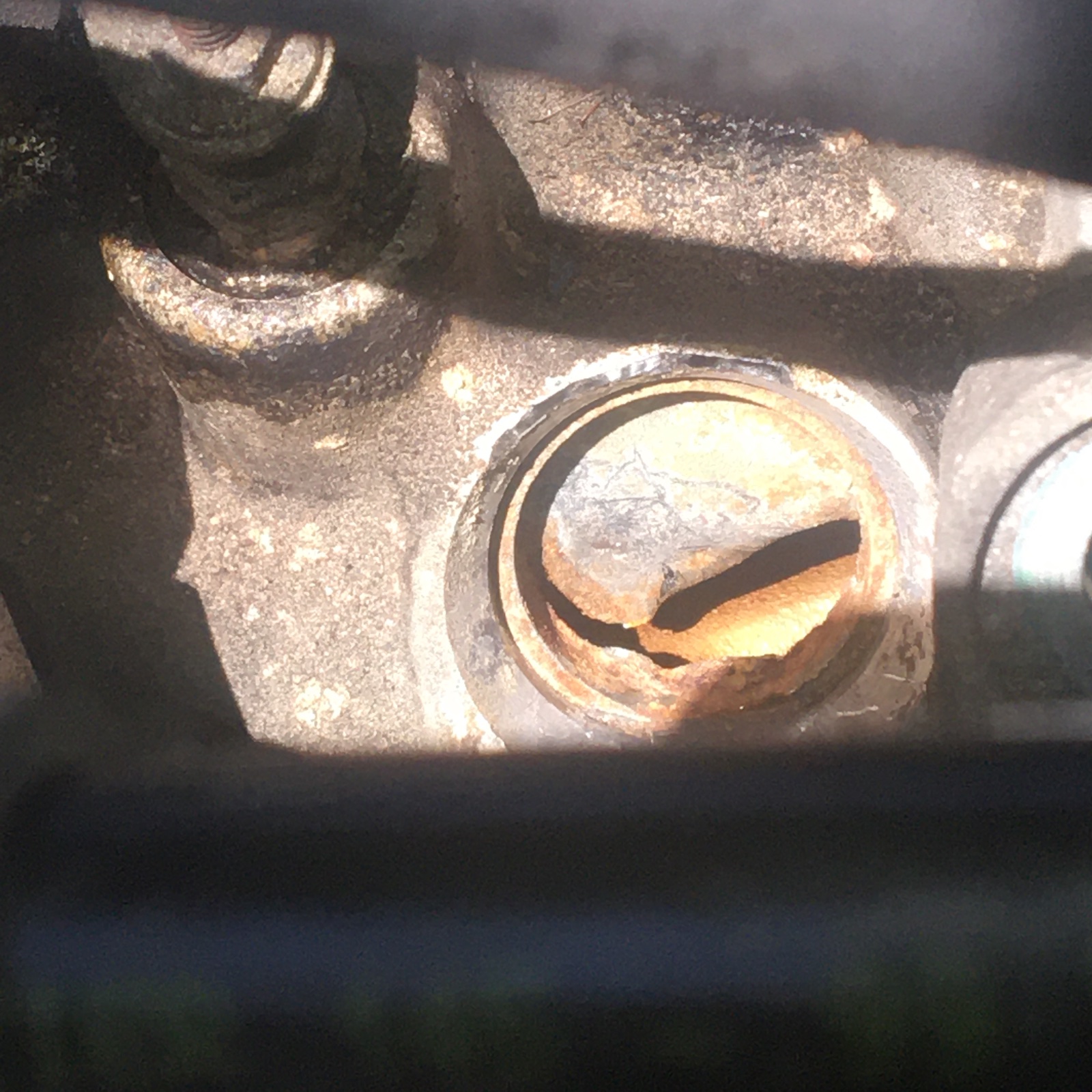

Re: Parts No request
Same as this one but better photo
Thanks Chris
I'll have a measure up and see if 25mm is close.
I'll re-post if I need anymore help ....

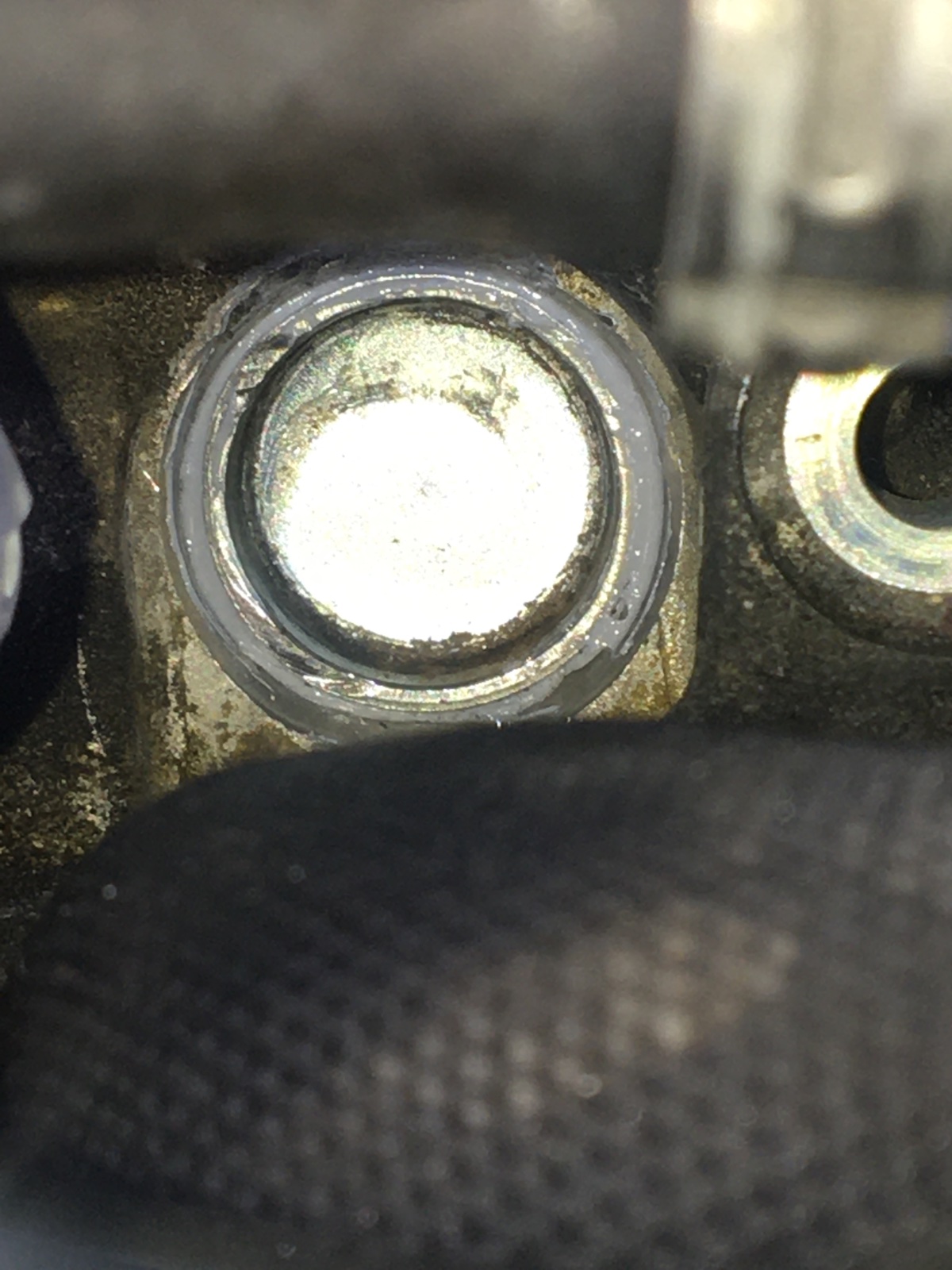

Bit of a faff getting access, I had intended to take the fuel rail fully off but the rubber breather pipe that runs over the rail is rigid and will probably break if I try to remove it ....anyway undone all the connections on the fuel rail and managed to lower it 2” which gave me enough access to remove and replace plug .... first one I’ve done so not sure if it’s in far enough? I hit it with a 16mm socket and Hammer - it doesn’t seem to want to go in any further So will let the sealant set overnight and test tomorrow

Re: Parts No request - Xantia HDi CORE PLUG
Looks to be holding under pressure - just needs another flush and some coolant in a couple of days

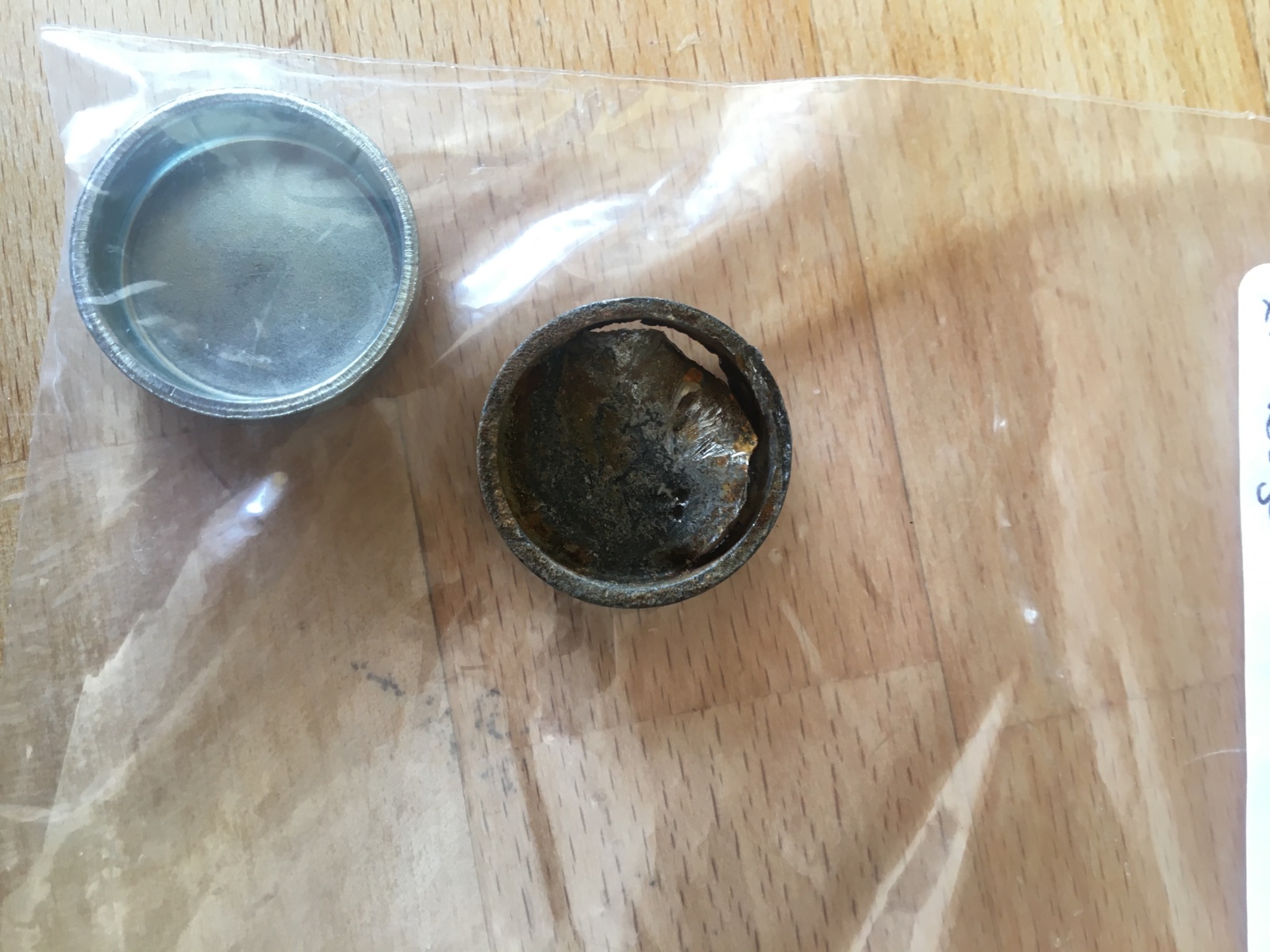

Glad to hear it's sorted. Back in the middle of the last century (how do I know?) those things could be 3-4mm thick - but then it was common not to bother with anti-freeze/coolant/corrosion inhibitor on a lot of cars!
