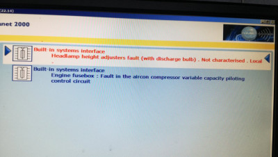

I'm new on this forum, but i'm sure not new to the brand, right now i'm trying to fix the A/C on my 607 2,7HDI 2005, i'll attach a picture from the code that i got from PP2000. Don't mine the first code about the auto high headlights i figured out it's the front height sensor, any prior experience or help with knowledge or diagrams is much appreciated.

Quick question... Does the AC pump clutch engage.
If no
Have you check the circuit pressure on the high and low sides ?
x 6963
Re: Peugeot 607 aircon codes that i can't figure out
There should be a fault code itself. Click onto the faults, then confirm, it should take you to another screen with som e more detail and the actual code.
Pop those up with your VIN

Problem is fixed, it turn out to be a loose connection, previously the clutch will engage the freon is good, but the variable stroke on the pistons in the aircon compressor will not pump the freon around. here is a pic, outside is 25 degrees, in the vents is blowing 4 degrees.
