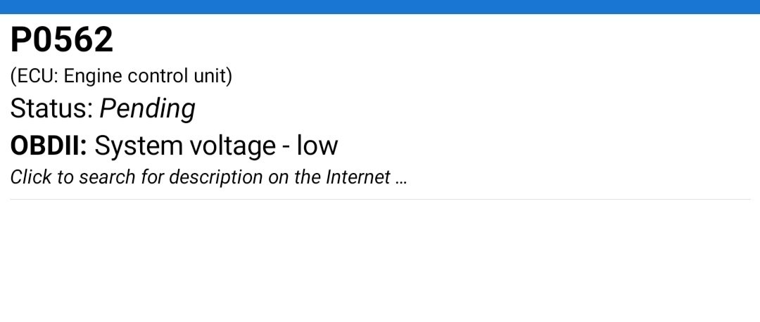

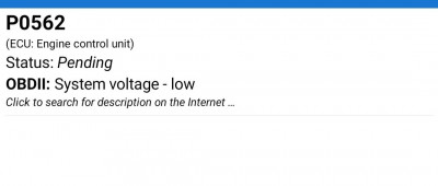

Scanned with obd scanner and the results pic is attached , so i guess its my battery that should have been replaced?

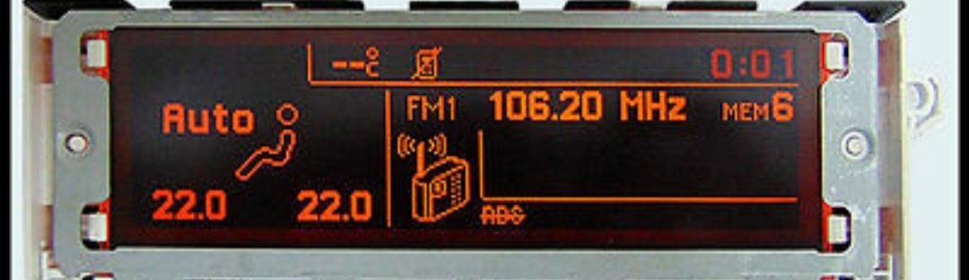

By climate parameters i meant like in the photo i add
Saw in a few videos and photos that this data i shown on the screen

I would seriously consider replacing the battery. The C series Citroens have a lot of electronics, and are very sensitive electrically. A weak battery can throw up all sorts of faults, and they don't have to be related. Recently another forum member had issues with their Citroen, and when they replaced the battery all of the issues went away (including the one causing the EML to come on).

P0562 means that various ECUs are underpowered. This can affect many ECUs and means it's probably time for a new battery.Shaib7 wrote: 26 Apr 2020, 12:00 My vin is VF7**************[VIN obfuscated, can be read by forum staff]

As for the display in your picture, there are different versions that are fitted to a lot of Peugeot / Citroen vehicles and they will display information differently depending on the model they are fitted to. The Head Unit (RD4) in your case is used to change the units of the system (KMH / MPH or temperature to Centigrade or Fahrenheit) and the date and time info as well as the radio settings for example. But your climate control panel indicates the temperature settings for front passengers on its dedicated display.

GiveMeABreak - if im getting you right , the climate can be shown only on the climate unit itself?
So theres no way to show it on a screen ? Maybe upgrade my radio to a citroen multimedia /android ?
