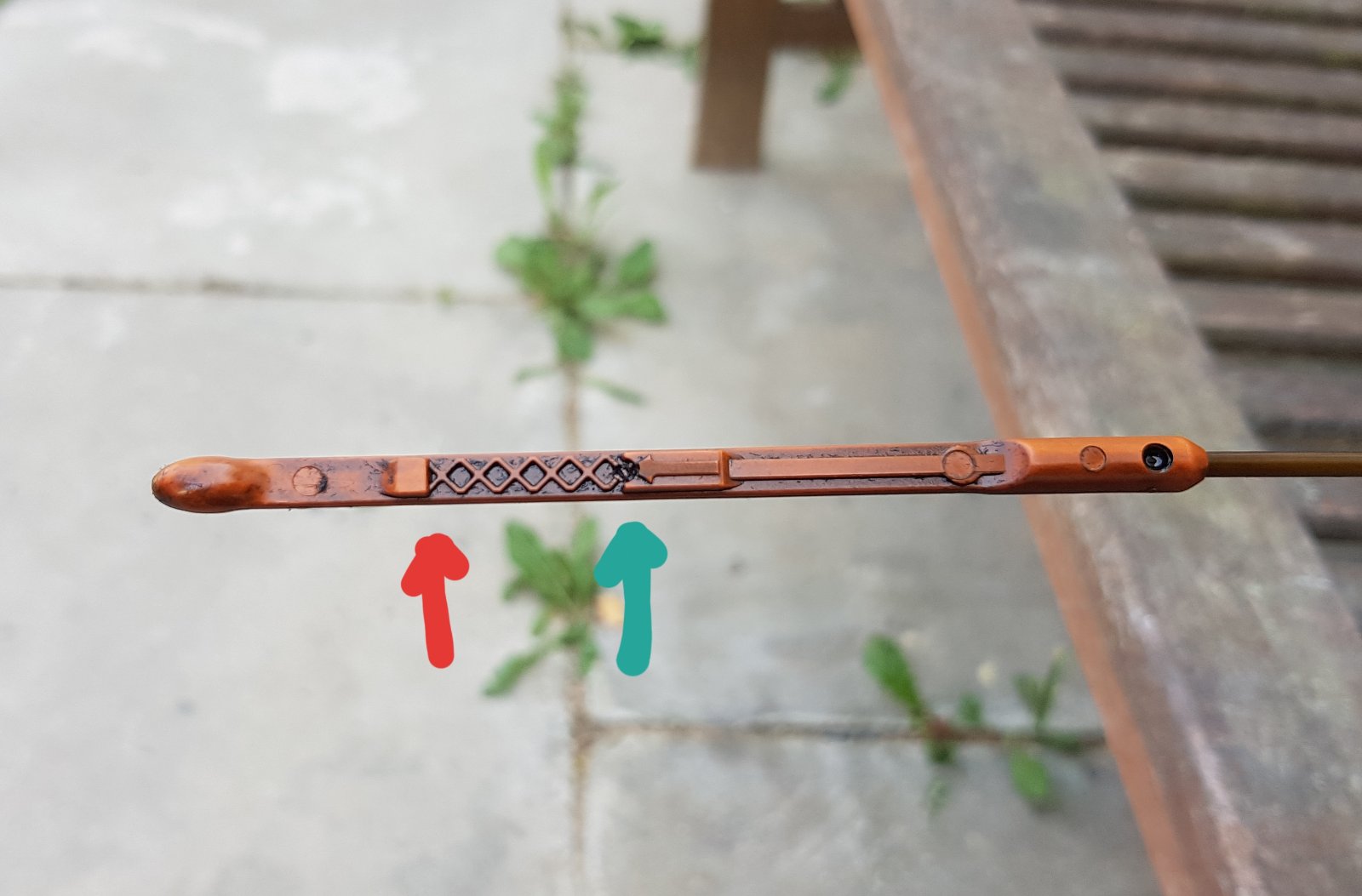

After buying my C5 I checked the oil level manual. The car shows level ok but after finding other fluids being over max I thought I check oil.
I drove the care a few miles and let it stand for 30 min on a level spot.
The dip stick was at least 5 cm above the crosses and the downwards arrow which I guess is the oil level.
Is there any reason why the level comes so high above the indication on the dip stick.
The engine is running a little rough, meaning more vibrations I would expect from a citroen.
It has done 154k and I see no leaks on the engine.
What is your advice. Do I drain. Do I change the filter. How do I know how much should be in the engine.

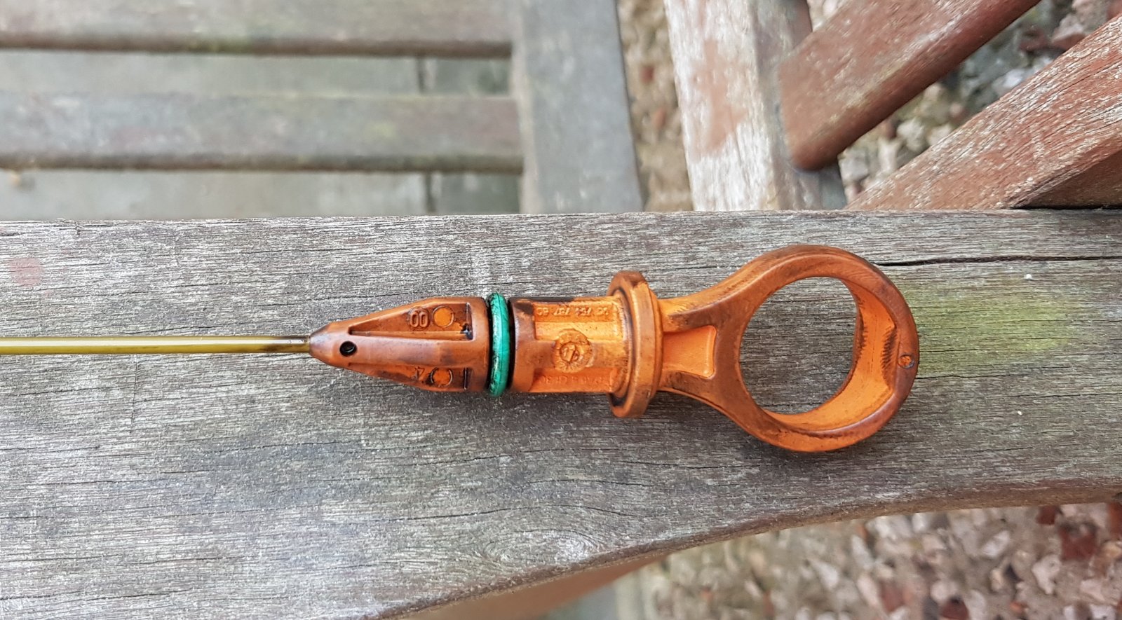

Reading out the oil dip stick
Dear all,
I'm trying to get my oil level back where it suppose to by sucking it out the dip stick tube as I can not get to the sump.
I might be a dip stick myself but am I reading the level right. The manual does not show the same type which is used.
I'm presuming the xxxxx <-- is the safe level and the dip stick top needs to be full down and not stopped at the green O ring.
I'm trying to be safe because I already taken 1 ltr out by suction and it's still not on the arrow
Anyone who can give me good advice during garage lockdown
Regards
Bela
Regards
Bela
