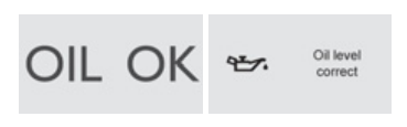

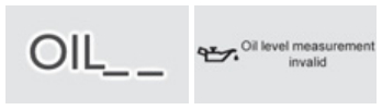

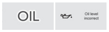

So you need to make sure the ground is level - wait for at least 30 minutes before starting the car, then turn on the ignition only and then after the service info is displayed, it should display one of the 3 messages - the last one in the table would tell you it is not functioning. So if you are not getting any of these, then take it back to the dealer.
There is no combination of buttons to display the oil level. The level is still checked after ignition start up after the service info as I stated. All the other information is the same as what I've mentioned before.
| Oil Correct This is indicated by a message in the instrument panel. | Oil Level Incorrect This is indicated by a message in the instrument panel. If the low oil level is confirmed by a check using the dipstick, the level must be topped up to avoid damage to the engine. | Oil Level Indicator Fault This is indicated by a message in the instrument panel. Contact a CITROËN dealer or a qualified workshop. |
