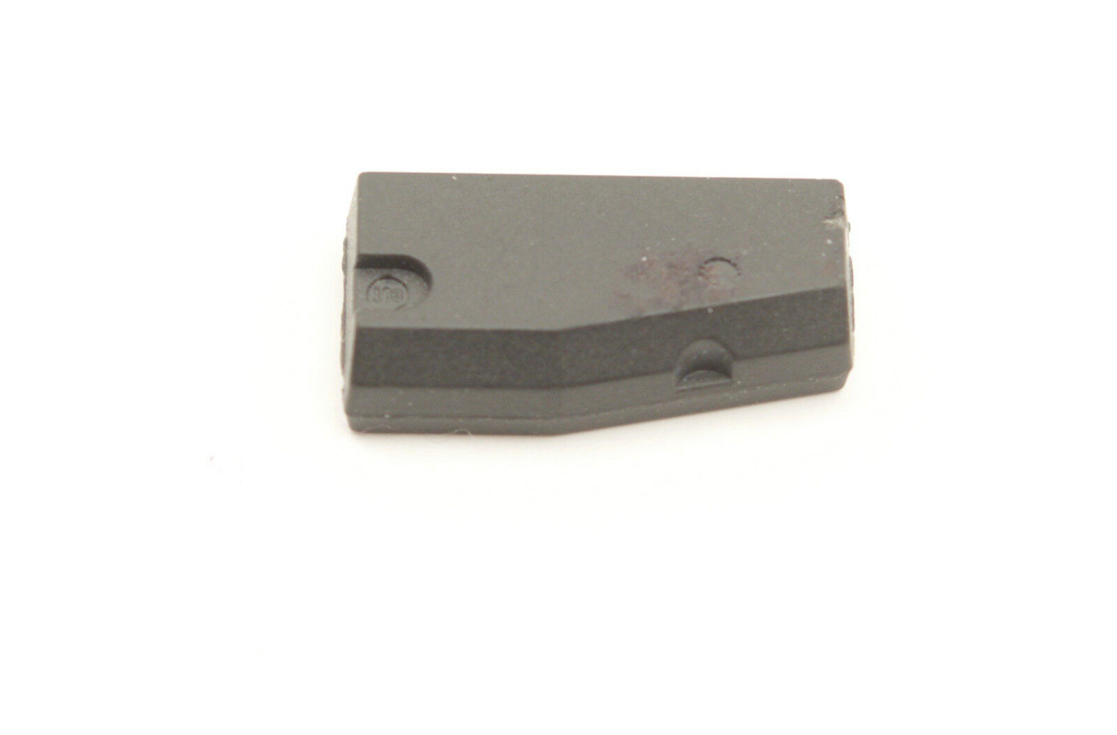

Have you tried starting the van with the spare key? the spare plain key should start the van.
If the spare doesn't start the van it may have become un synced with the van or its been replaced with an aftermarket one with no chip or never been programmed.
Can you split the key open & see if there is a transponder chip in it ?
Should look like this, not more than a centimetre long.
If you rule out the key might be worth just sticking a new transponder aerial around the ignition barrel on it, they are not unknown to start failing intermittently. They are normally quite cheap & I don't believe the need programmed on the Nemo.

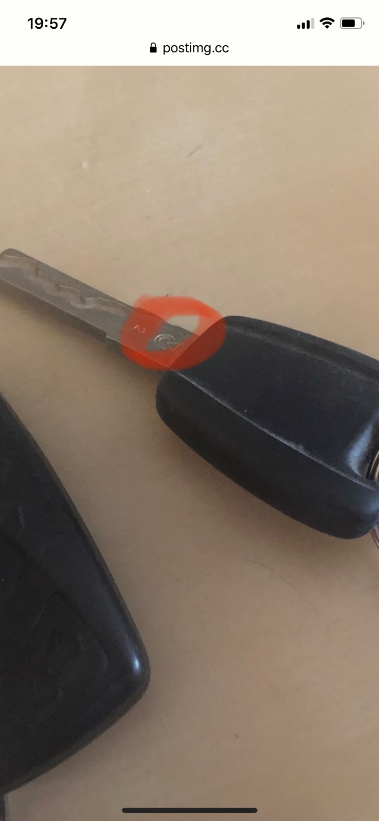

raiderz
- Posts: 9
- Joined: 30 Mar 2020, 12:10
Re: Nemo Van Anti Theft
These were the only keys I got.GiveMeABreak wrote: 09 Apr 2020, 10:22 My info shows there was only the full electronic fob type of key for the Nemo available, so I suspect you may simply have a copy of the key blade cut for the spare that you have without a transponder chip - so that won't start the vehicle, only open the doors.

wheeler
- Posts: 7927
- Joined: 21 Sep 2002, 19:07
- x 1056
Looking at that keyblade id say it looks like a genuine Fiat key due to that little symbol. You wouldn’t normally see that on an aftermarket key.
Does the key turn in the ignition?
