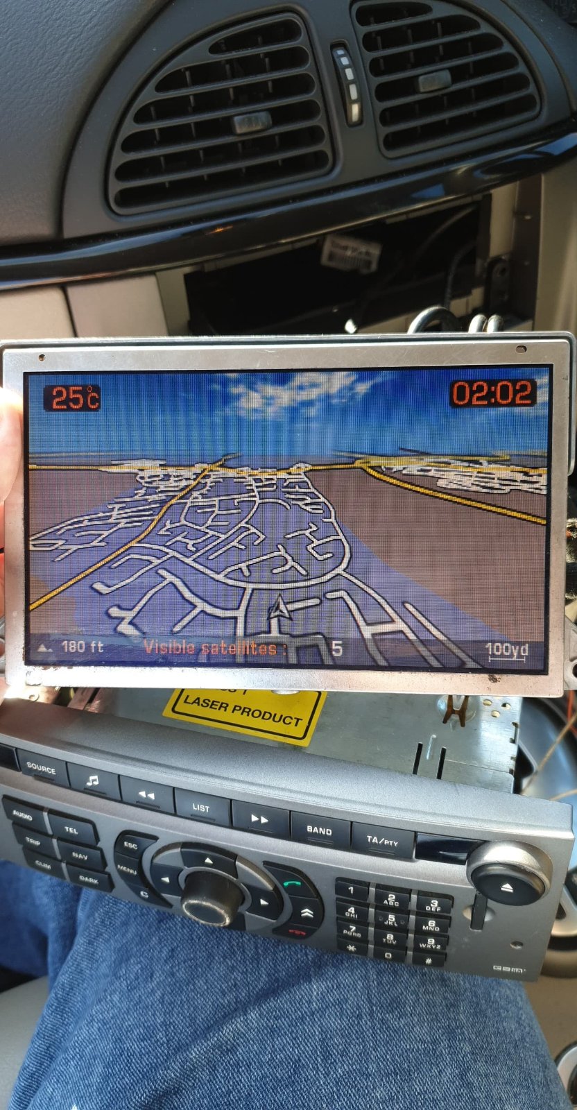

Hi all! In my madness i have decided to add the RT3 sat nav , replacing the small hump non nav radio.
So far so good - cut out the hump, removed the small screen, installed the mount and large screen, checked the radio work (and rewired the 3 small wires to the screen - that all works) and the nav even picked up satellites and the phone.
But - when coming to code it on lexia (the joyful beep) ran into a large block. The radio ecu is not detected and the telematics (once enabled in bsi and as present in the cu section) has a ? next to it. Not sure where to go from here?

Mine is a m1 facelift and the nav system is also from a facelift - both are canbus i think

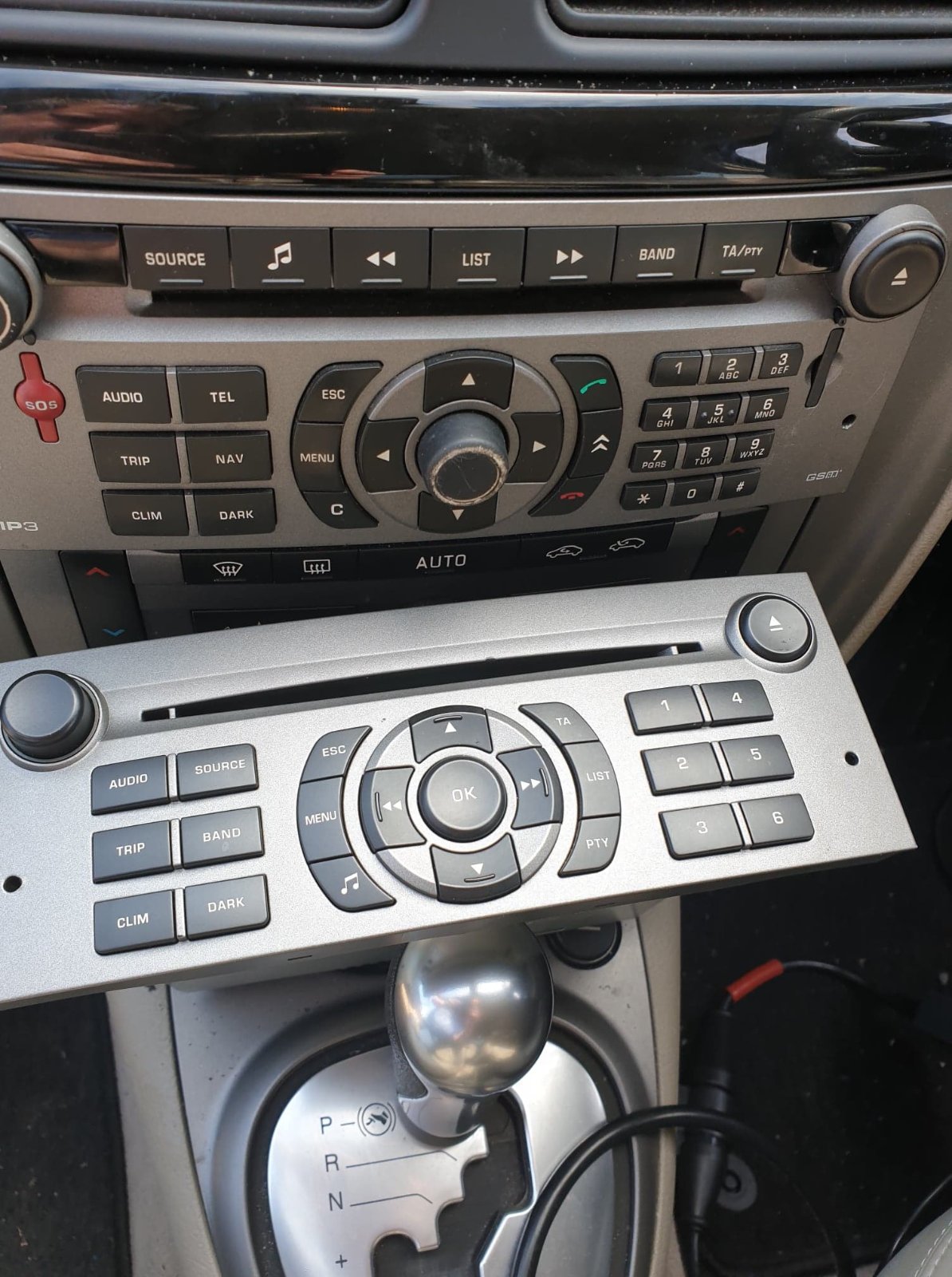

Bottom is an RD4 X3 N1 EU
top is an RT3 X3 N1 EU

Its an RT3EV - was told to look on the back of the unit at all the connections
