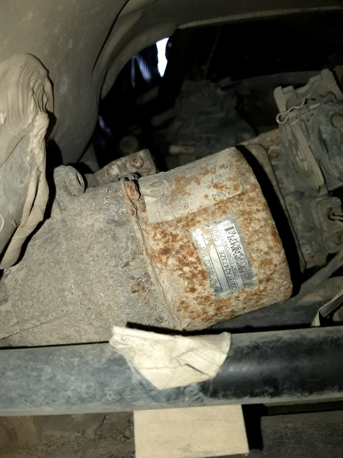

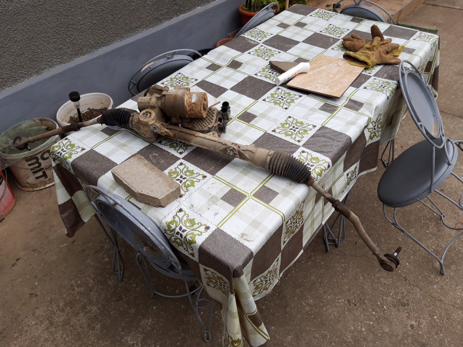

I found reconditioned rack at 600E and I have in mind to take out the old rack, also the steering motor is heavily rusted.
I taken out engine fusebox and inspected, nothing looks wrong. Regarding the smell(it was perfectly sealed fusebox) now I can say it smells like new TV electronics smell not like burnt, I just hope my nose is not tricking me

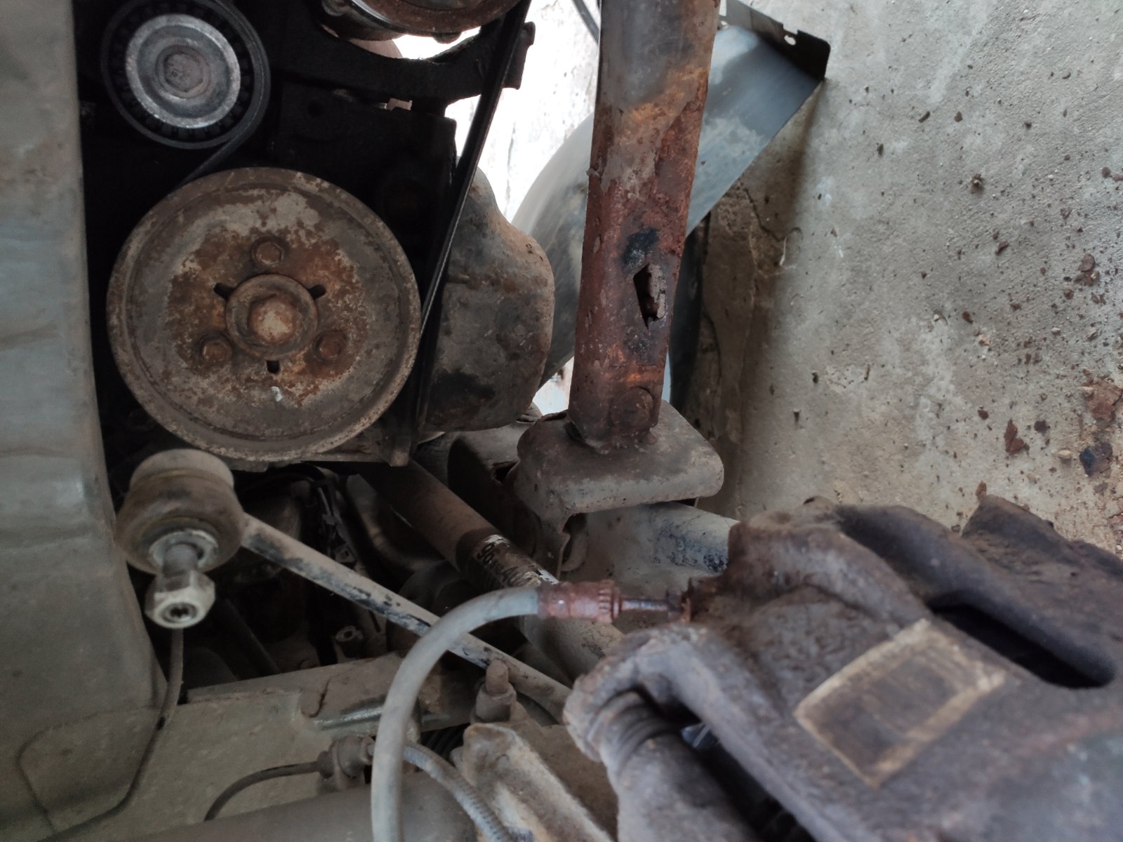

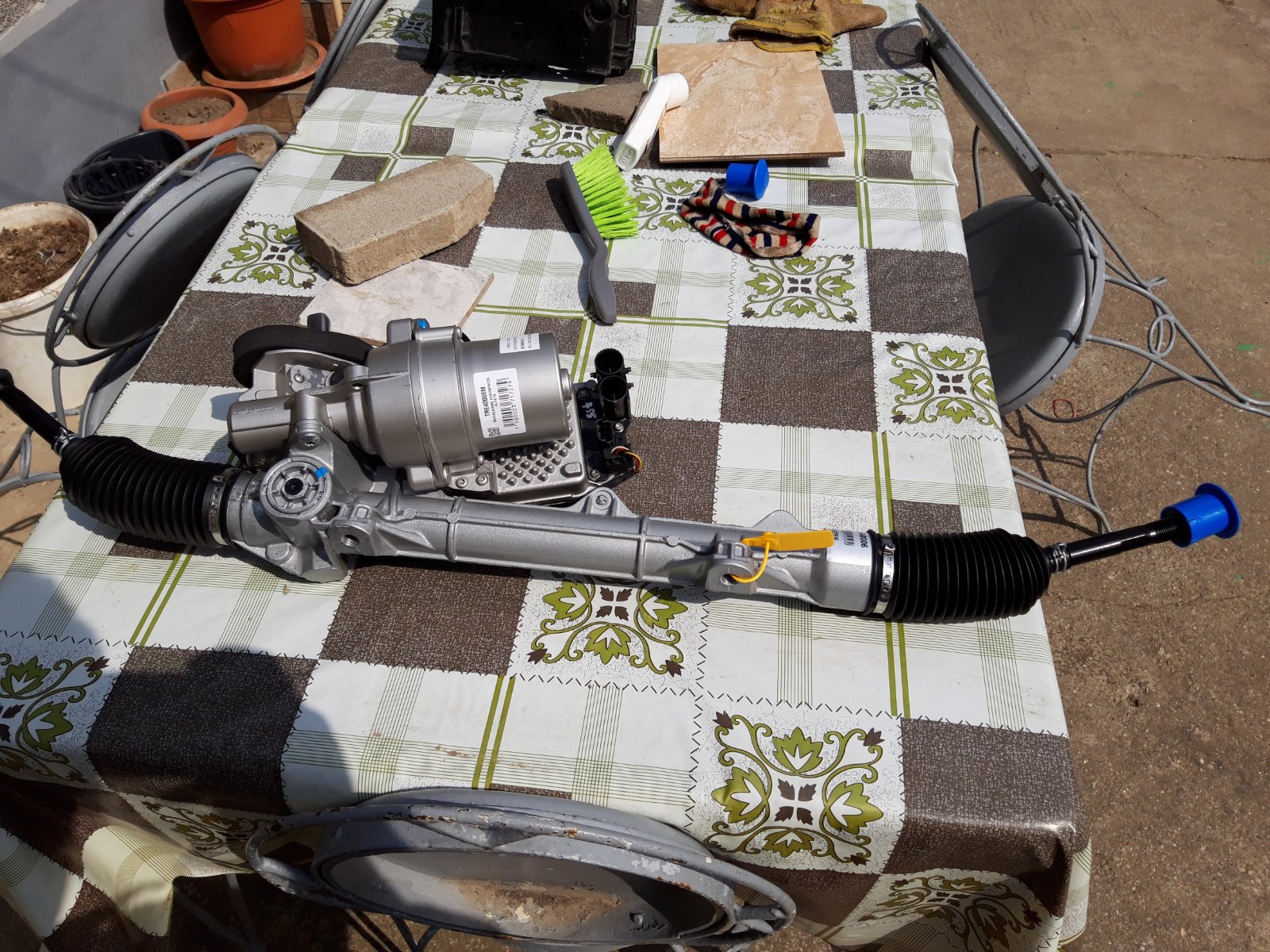

My refurbished steering rack arrived, I hook it up on engine bay and its working, now I need to continue dismantling the front axle...
In my front axle dismantling I found rusted screws and rusted extension bars that I took out for clean and repaint. If your car dose not have engine shield mont one now ! or rust in peace !

Flip! That will need a bit more than a coat of paint!
