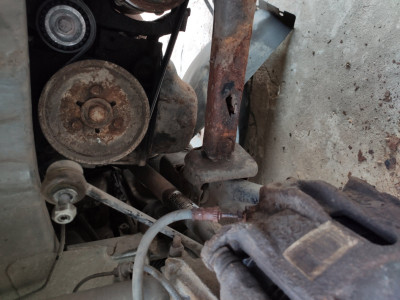

In my front axle dismantling I found rusted screws and rusted extension bars that I took out for clean and repaint. If your car dose not have engine shield mont one now ! or rust in peace !
My refurbished steering rack arrived, I hook it up on engine bay and its working, now I need to continue dismantling the front axle...

Flip! That will need a bit more than a coat of paint!
