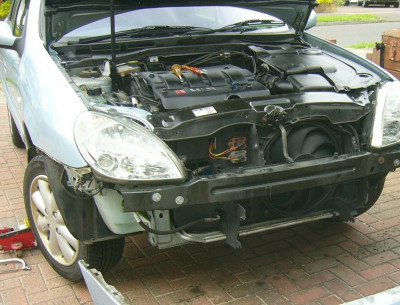

You don't need to fully remove the bumper, you can just drop it down enough at the one side to access the lower bolt.
Rough instruction from memory, undo the torx screws above the front grille, undo the screws that hold the wheel arch liner to the bumper, there is also a screw that goes up the way that holds the bumper to the front wing. Theres a few 10mm bolts on the bottom of the that also hold the undertray (if fitted). The bumper is held in place on plastic clips, you can then pull the bumper forwards to unclip it, this can sometimes need quite a hefty tug to get it to unclip. Once its unclipped you can drop it down at one side to access the lower headlamp bolt.

My daughter used to have a 2002 Xsara and about 12 years ago I had to remove the headlamp. I'm pretty sure that besides having to remove the bumper, I also had to loosen off the cross member to reach the bottom fixing bolt on the lamp.
