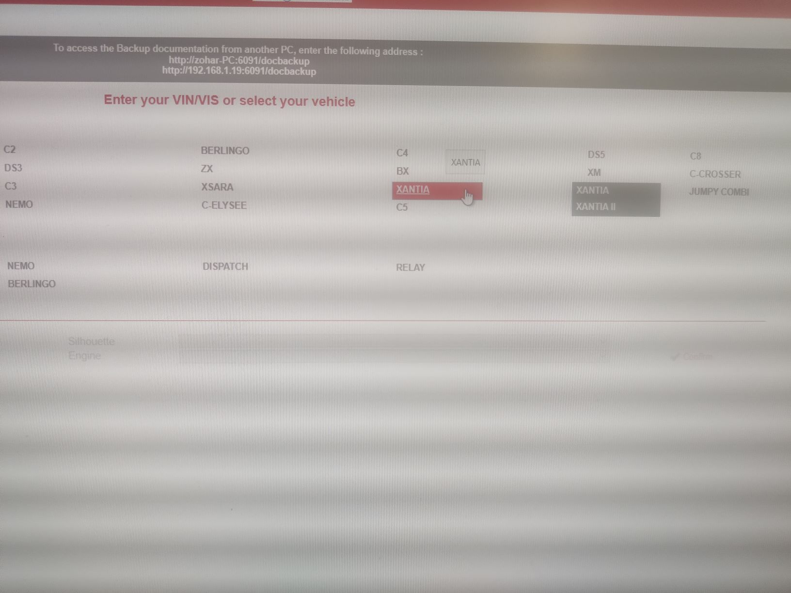

Hi,
When activating the Citroen documentation backup and pointing on Xantia the selection buttons between Xantia and Xantia II are far away from the Xantia and when trying to move the mouse cursor to one of "Xantia" or "Xantia II " than all of the buttons disappear. In order to make it operable the selections buttons should be dropped right next to the Xantia button ( The RED button in the picture ). Any one knows how to sort it ?

I found a solution. I set the screen resolution to 800x600 and then the Xantia selection type ( MK 1 or MK 2 ) dropped on the Xantia . After selecting MK II i revert to the normal resolution and all is OK.
