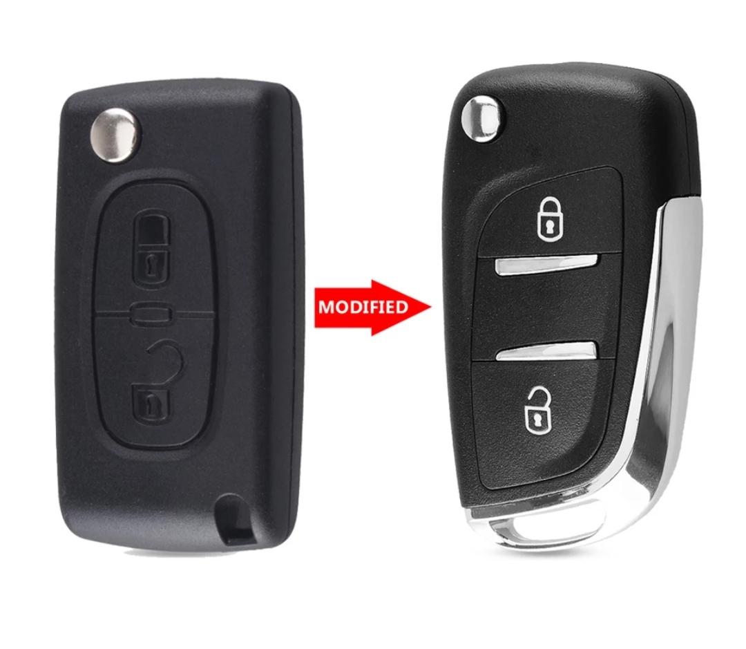

Thank you.Here is my problem.I have working chinese alarm remote and stock one with 2 buttons,than I have bought shell from images bellow for stock remote chip.Bought new battery as well,problem is that now stock remote dont work at all doesnt lock or unlock it just can turn on car.Tried sync method but no luck.GiveMeABreak wrote: 15 Mar 2020, 19:55 You’ll need the confidential customer pin code that was issued with the car at new, usually concealed on the plastic card under the scratch panel.

I'm not sure if I understand you correctly, so forgive me if I'm getting this wrong....
Are you transplanting the electronic card and immobiliser components complete into the shell on the right? If so, these new cases are are not designed for the older type - for a start, the buttons on the new case won't align with the microswitches.
If you have disconnected the battery (as in when you were changing it over), then the resynchronisation needs to take place again, but if the switches are not fitting the new case then the programming won't work.

Yes I have transplanted electronic card into new shell and buttons working,its modified to fits..

Re: 307 2006 program remote key
Just go to the 1 Star reviews - there's plenty there saying it didn't work (no metal battery support, once the transponder chip was in - failed to work) etc., so I wouldn't have touched it to be honest.

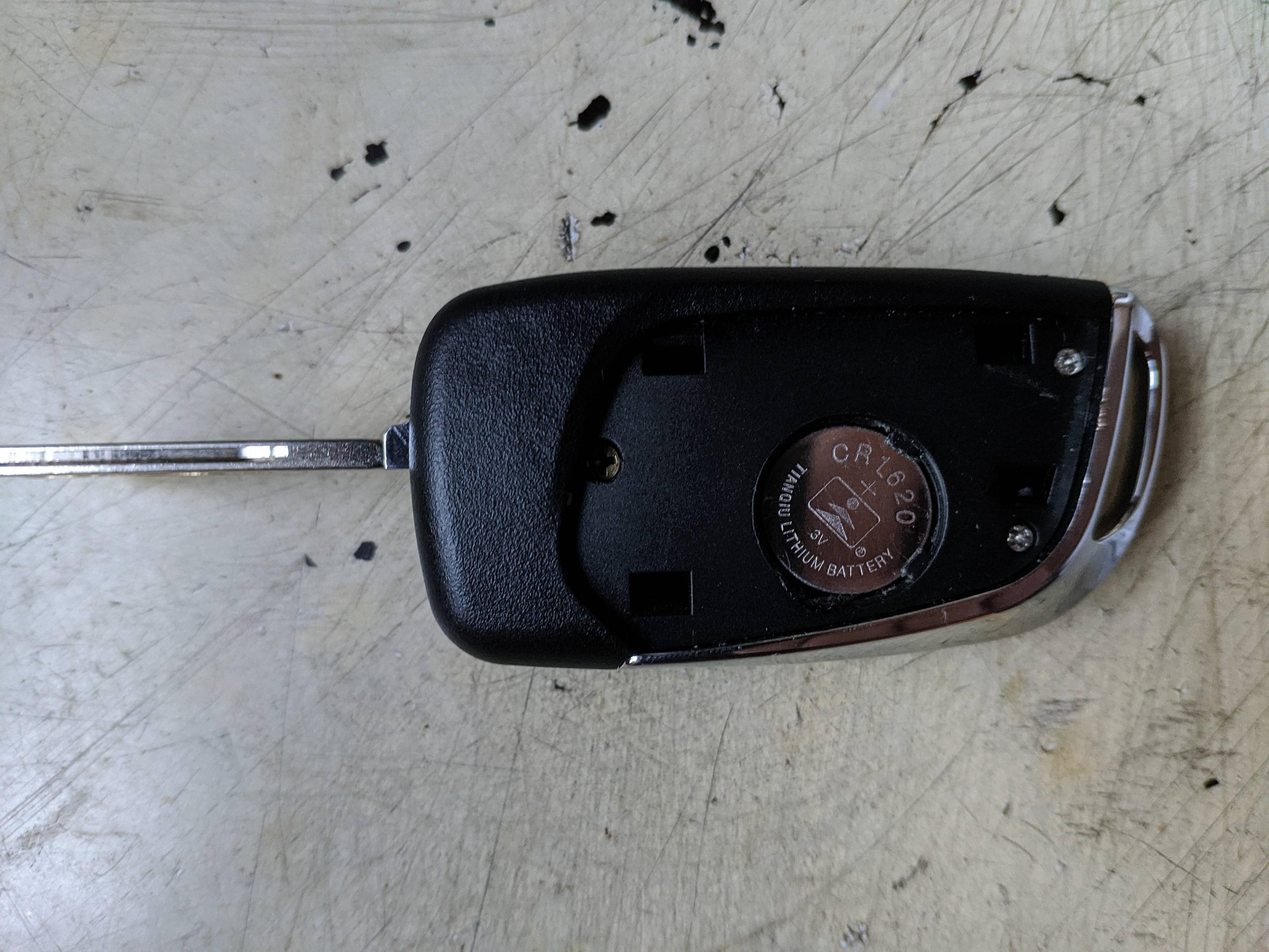

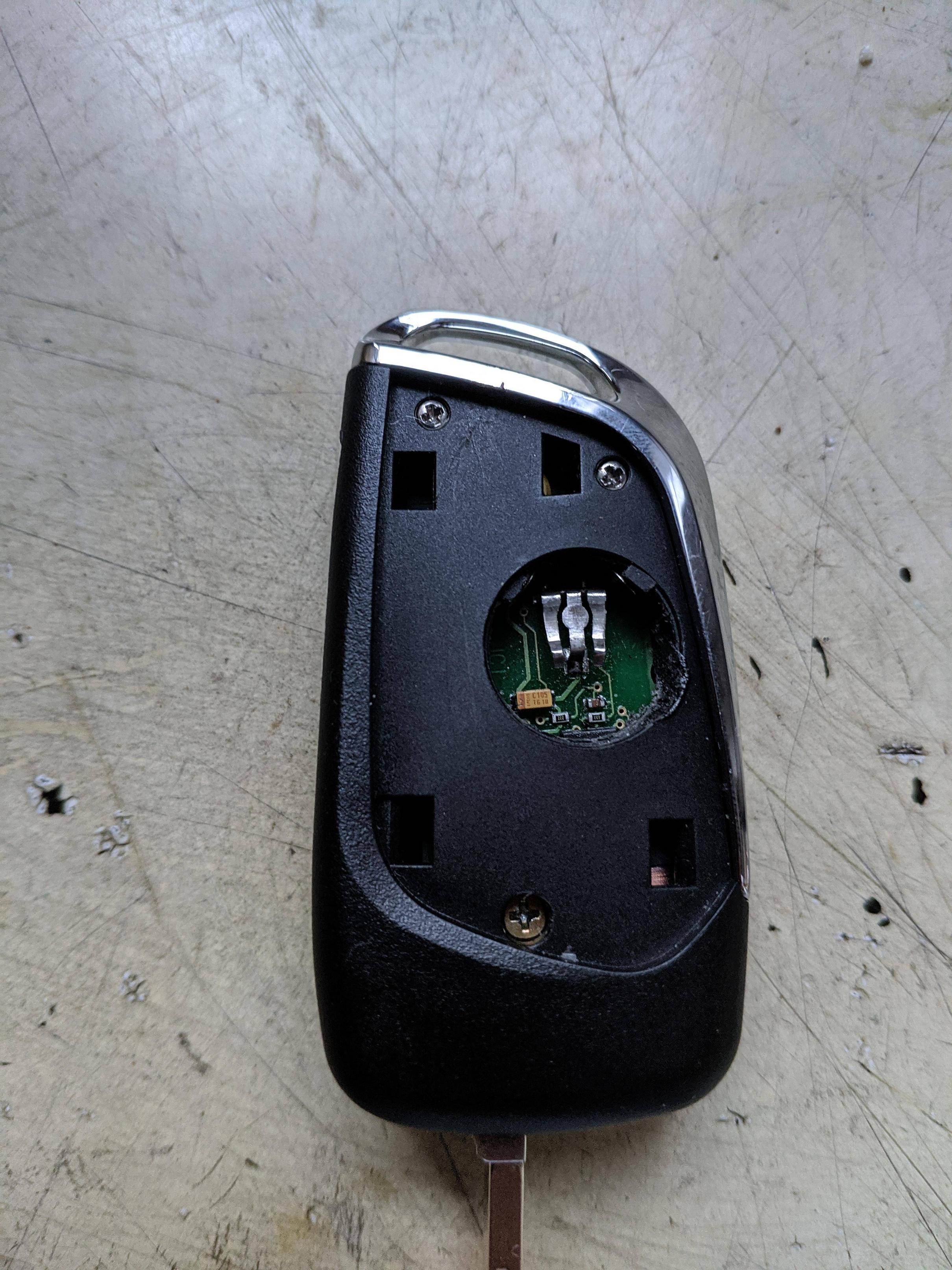

I see..But its strange why it doesnt work,because I can feel that button is preset,I feel click sound inside.I have even cutted this blade which was included in package,and it can start car.Maybe signal sometimes can pass trough shell sometimes can not.GiveMeABreak wrote: 15 Mar 2020, 23:56 Just go to the 1 Star reviews - there's plenty there saying it didn't work (no metal battery support, once the transponder chip was in - failed to work) etc., so I wouldn't have touched it to be honest.
- x 6945
It's a possibility that the metal pins / tabs holding the battery for the remote operation are not making good contact. The plastic around where the battery goes in looks very badly machined. If this is causing misalignment of the battery then the power for the remote functions won't get through. The battery is not needed for starting the car as the transponder chip is energised by the transponder coil in the ignition barrel, so that signal is getting through.
Thats probably issue because sometimes when I press battery by finger it working but rare,really dont know how to make good contact?GiveMeABreak wrote: 16 Mar 2020, 08:32 It's a possibility that the metal pins / tabs holding the battery for the remote operation are not making good contact. The plastic around where the battery goes in looks very badly machined. If this is causing misalignment of the battery then the power for the remote functions won't get through. The battery is not needed for starting the car as the transponder chip is energised by the transponder coil in the ignition barrel, so that signal is getting through.
- x 6945
You may need to look closely at the battery cut-out and see if the plastic round the edges of the battery socket need to be trimmed slightly. You might also try gently levering the metal contacts out a little and underneath where the battery sits to see if that will make better contact. But if the plastic around the edges is not quite the right shape, then when you put the case together, it may be pushing the battery out of place.

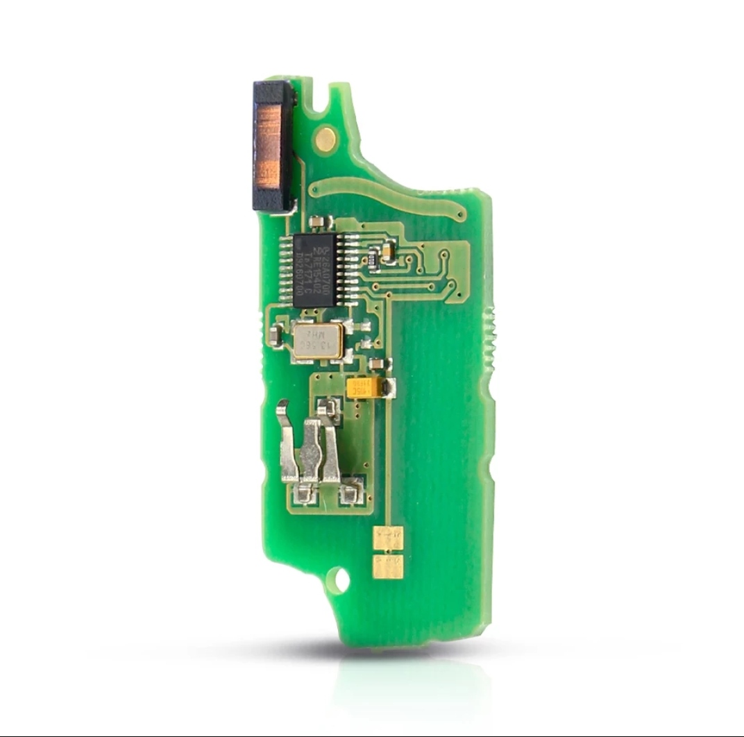

Ok I got confidental code,paired keys with diagbox but this remote now doesnt working anymore..really dont know why.Now which remote chip can replace this?GiveMeABreak wrote: 16 Mar 2020, 09:24 You may need to look closely at the battery cut-out and see if the plastic round the edges of the battery socket need to be trimmed slightly. You might also try gently levering the metal contacts out a little and underneath where the battery sits to see if that will make better contact. But if the plastic around the edges is not quite the right shape, then when you put the case together, it may be pushing the battery out of place.
It's one of the issues with fakes / copies / modifications of the originals I'm afraid. You know the Chinese, they'll make copies of everything!
I bought a fake replacement Samsung TV remote for a few £s last week and although it looks genuine I knew it was a cheap copy - the buttons are more stiff and I know if I drop it, then it will probably smash into a million pieces - but for £3 I can afford to drop a few!![]()
https://www.aliexpress.com/item/4000061 ... hweb201603_
Here is chip which I have issues.
