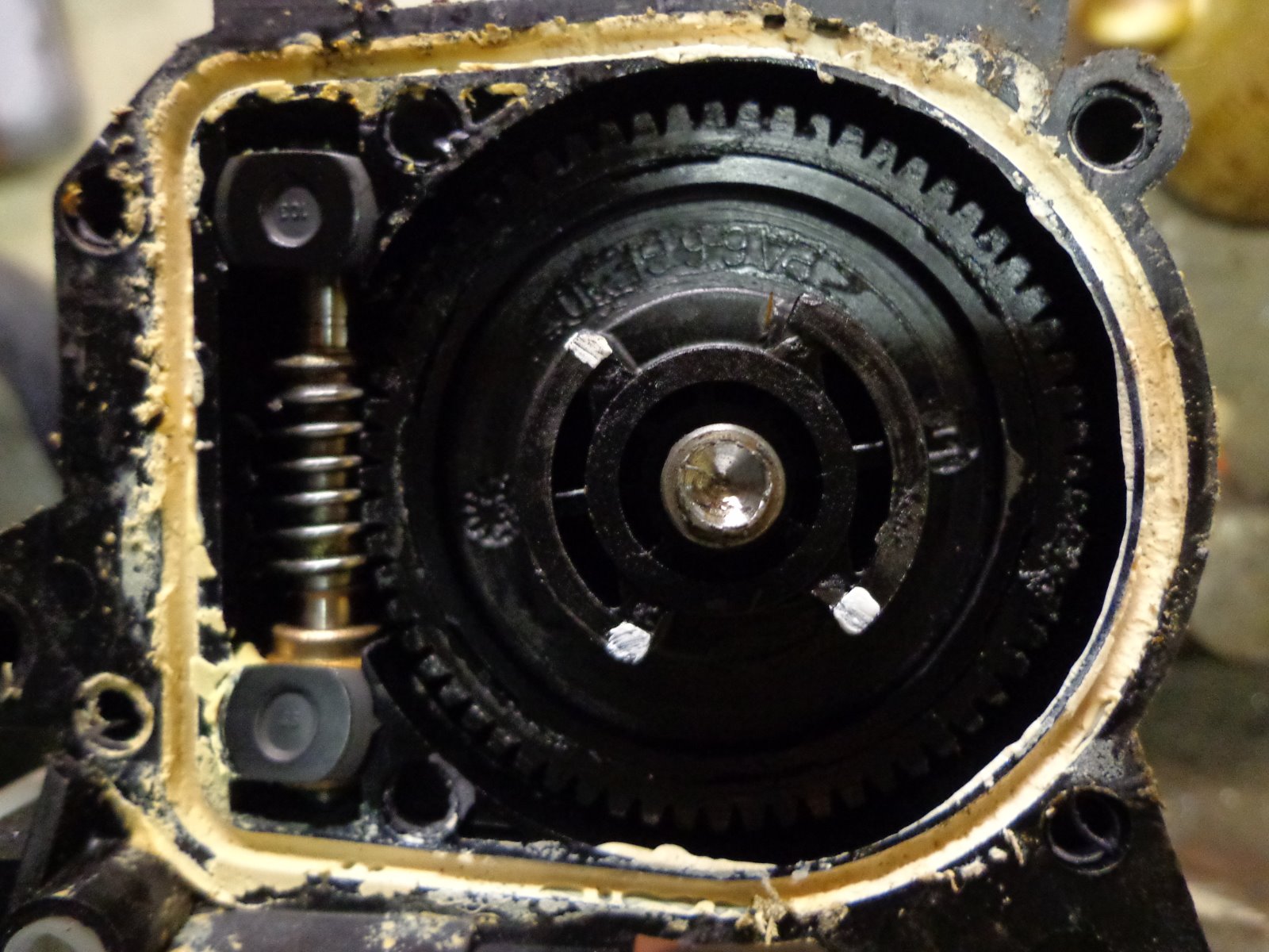

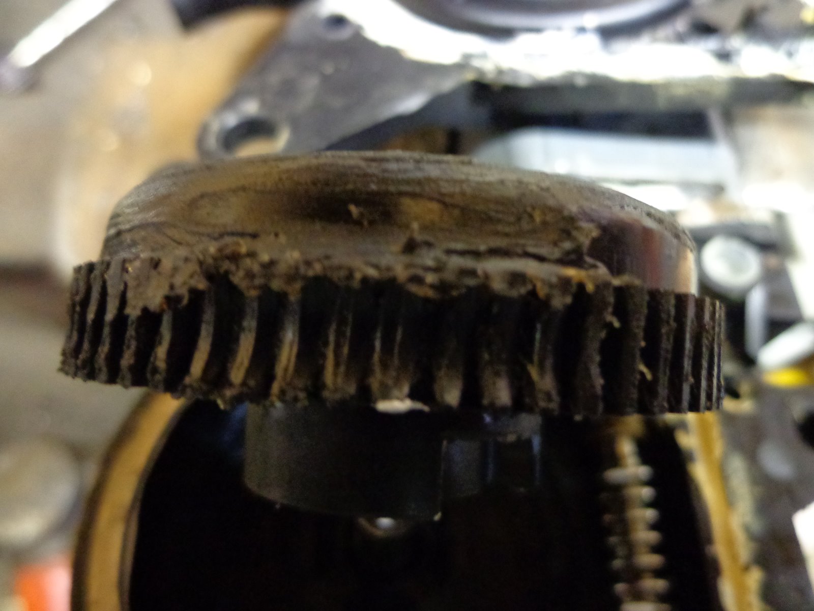

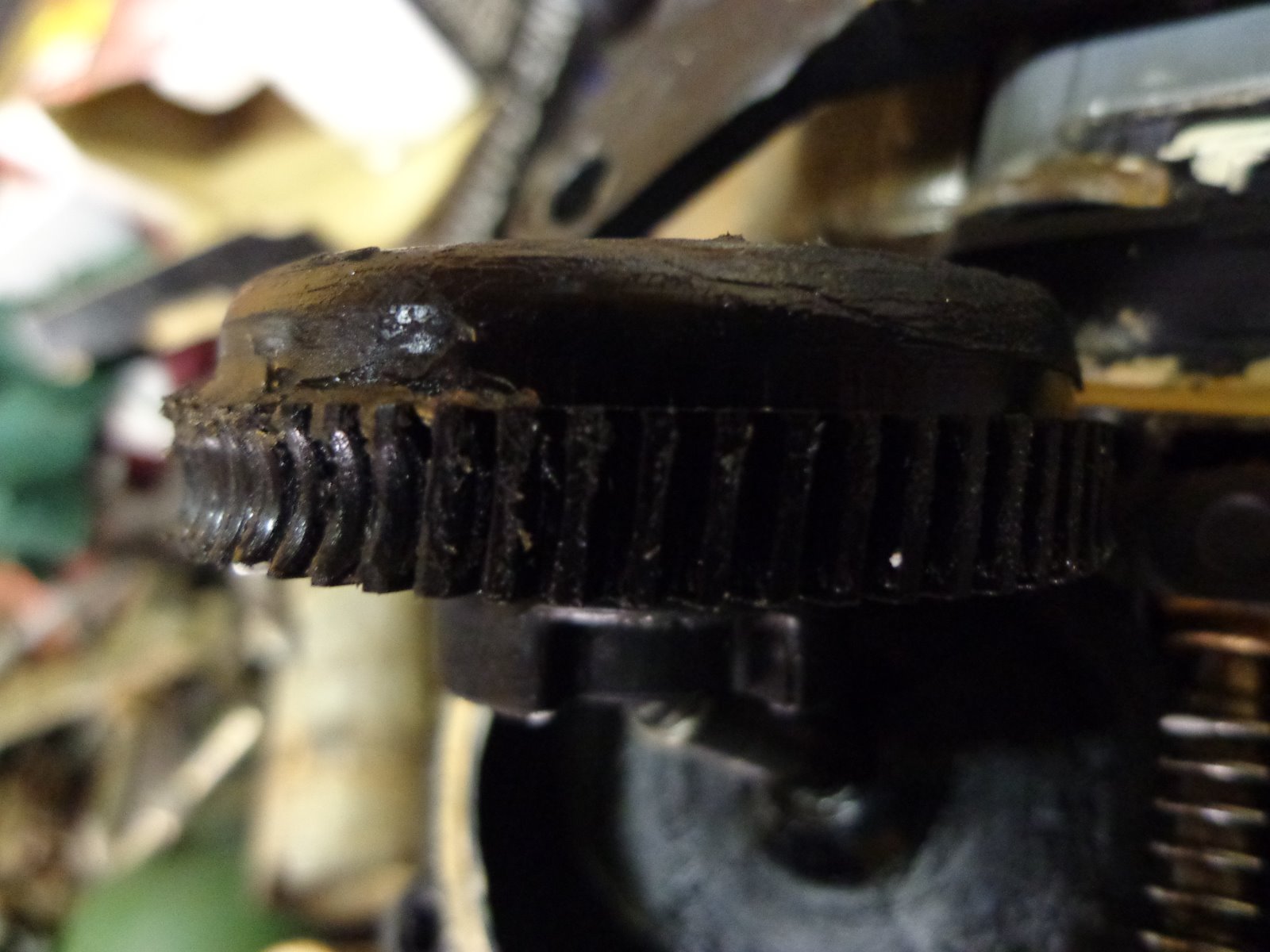

The drivers door window would only go up so far then stop with winding noise, could be pushed up and re-engage for another height before more winding noise. As I suspected the motor drive gear has ground away the plastic drive gear. Having said that, in order to access the drive mechanism meant drilling out the plastic welds and the metal cover plate shaft. All fixable provided I can get a plastic drive gear replacement. Checking on the forum I could see any comment about availability of this part. Your advice please.

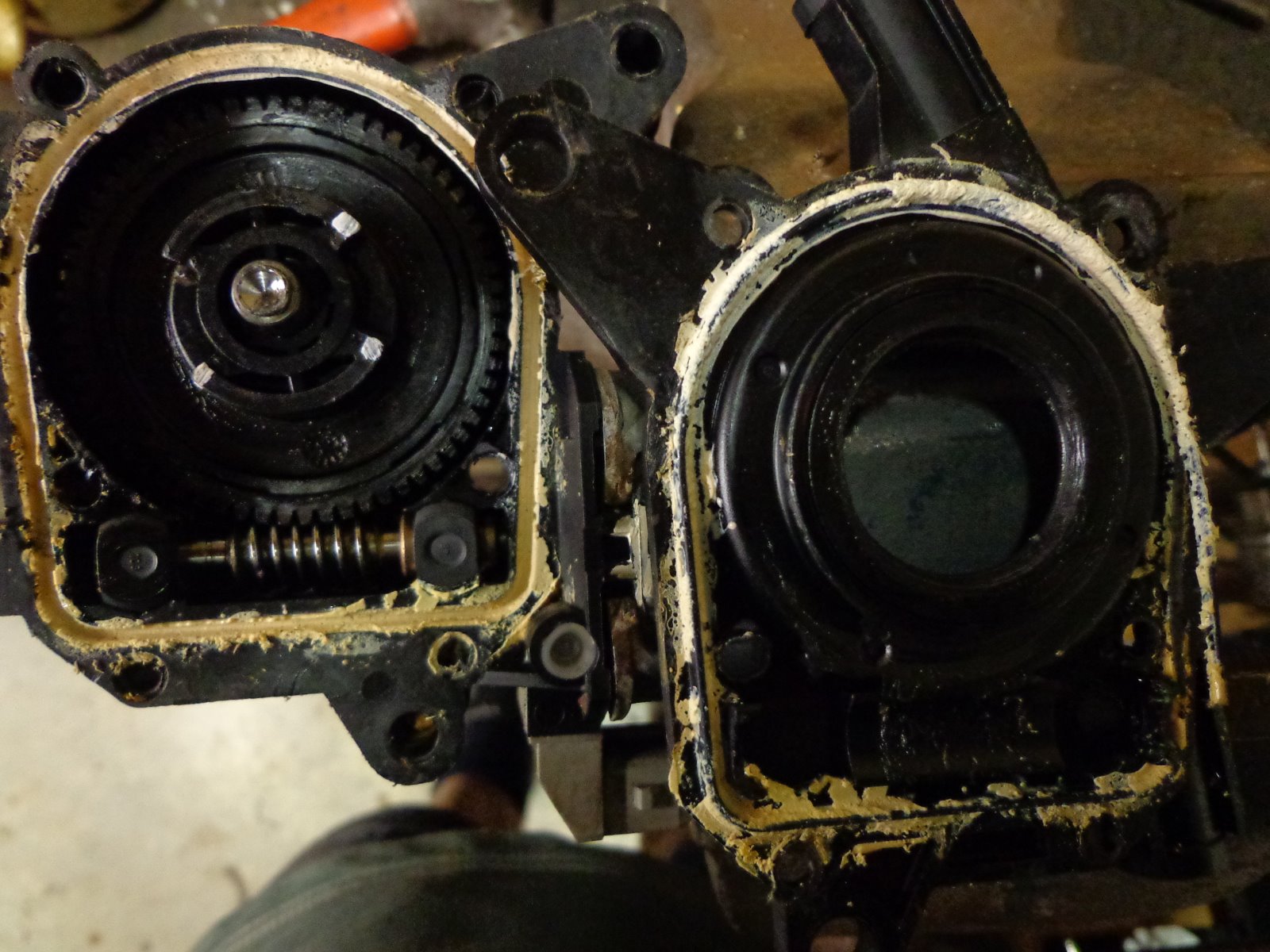

The first replacement window regulator ex wrecked Xantia had the same problem, main drive plastic gear stripped at point when the window comes to a stop. Alan Sklenars sent up a couple of rear window regulars that he'd tested with the windows in place, and I used one of those. Drilled off the cover plate to replace the winding spool, wires and track with my front window parts, tapped the cover plate shaft to accept a hold down bolt and refitted to the car. Works well. Interestingly I had to change the polarity of the supply to the motor to get the same up/down from the switch as for the passenger side front window. Why that is I don't know. And i have some spare parts now in case of failure of the drive gear or the other plastic parts in case the "new regulator" fails in another 26 years.
