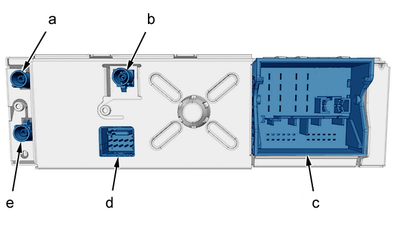

Incidentally, the GPS aerial port at the back is 'b' in the diagram below:

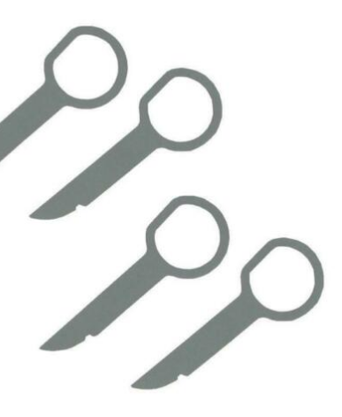

Did you get this sorted? Having exactly the same issues, with probably excactly the same car, year, model.
Wondering what kind of tool to use to get the unit out of the dash/console to access the fakra connector on the back. Seems to be 4 flat tools. Also, did you get a GPS antenna replacement?
x 6959
Re: Peugeot 3008 2010 MyWay RNEG issues
You'll need a set of these top remove the RNEG units. Cheap enough on ebay. (https://www.ebay.co.uk/i/382262018402?c ... gKis_D_BwE)

Hi, all, I'm new on here and hopefully someone can help with the "Fakra Connectors", So the diagram of the rear of the head unit as shown by 'GiveMeABreak' is showing "b" as the GPS antenna!
Maybe 'GiveMeABreak' can tell me what connects to "a" on the diagram and what connects to "e" on the diagram? and if I may need any adaptors.
I am hoping to install an after market unit specifically made for the 2010 Peugeot 3008 with Plug & Play connector but I still need to connect the 3 Fakra connectors to the appropriate connections.
'a' is the FM2 Aerial (not used on this unit)
'e' is the FM1 / AM aerial.
Unread post by securityman »
Thank you so much! However "a" on my unit has fakra connection but like you said it may well be that having the connection doesn't mean it's being used. So my understanding is that "a" can be left disconnected, am I correct. Secondly if you can advice, my after market unit obviously doesn't have male fakra connections so I do need some sort of adaptors and will using them make the unit work?? Again Thank very much
The reason for the different aerials is that some models like the RT6 and the NG4 have dual tuner systems. This basically means on those systems that 1 FM channel provides the signal for the current station and also for the AM signal, whilst the second FM aerial is used to constantly monitor the frequencies to select the best signal and can switch over. So if your aftermarket system only has one FM port, plug aerial that is currently in connector 'e' into the aerial socket on your new unit.
Of course you will need a FAKRA to aerial converter like this:
https://www.halfords.com/technology/car ... 82145.html
