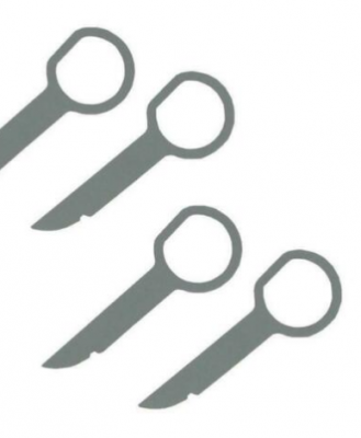

Did you get this sorted? Having exactly the same issues, with probably excactly the same car, year, model.
Wondering what kind of tool to use to get the unit out of the dash/console to access the fakra connector on the back. Seems to be 4 flat tools. Also, did you get a GPS antenna replacement?

You'll need a set of these top remove the RNEG units. Cheap enough on ebay. (https://www.ebay.co.uk/i/382262018402?c ... gKis_D_BwE)
