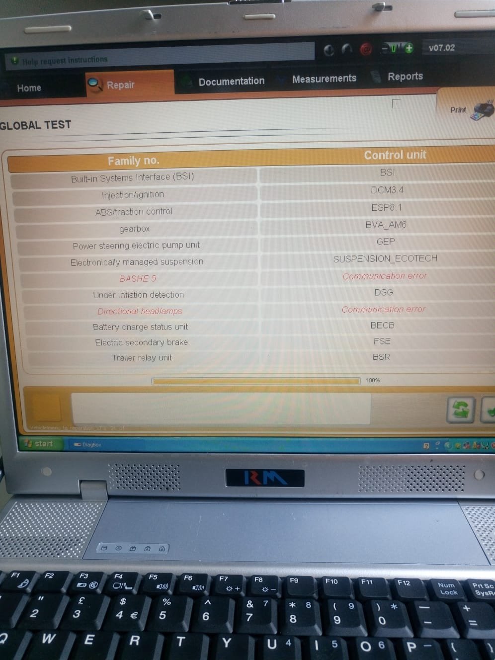

mystery solved. There is no engine ECU listed on the global test menu.
There is one listed as injection/ignition is this where I need to look?

Posts: 14275
x 3280
Re: the dreaded low additive warning
That would be where I would start.
x 6962
Bandit12 wrote: 12 Mar 2020, 18:28 mystery solved. There is no engine ECU listed on the global test menu.
Gino
DCM3.4 is the engine ECU
