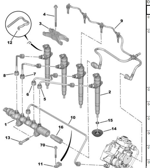

Appears that they share a clamp and a single bolt, good chance the bolt is loose or broken

Injector clamp bolt was loose. Tightened it up and noise has gone and starting now easier.
Given it was loose I guess I should be replacing the copper washer, but at least it now sounds normal again.

Do replace the sealing washers; they've probably been hammered.
