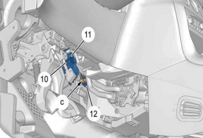

Re: Citroen ds3 blower motor
Are you sure you need to take the fan out and not just change the blower motor control unit?
Remove:
The (10) bolt
The heater matrix pipes retaining plate (11)
Unlock: The blower control module (12) (Quarter turn).
Disconnect the connector ( as "c").
Remove the blower control module (12).
If it's the actual motor you are sure you want to remove then diagram below:
Remove the bolt from the air duct.
Move aside the air duct.
Remove:
  • The (10) bolt
  • The heater matrix pipes retaining plate (11)
  • The air blower (Turn a quarter of a turn)
