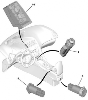

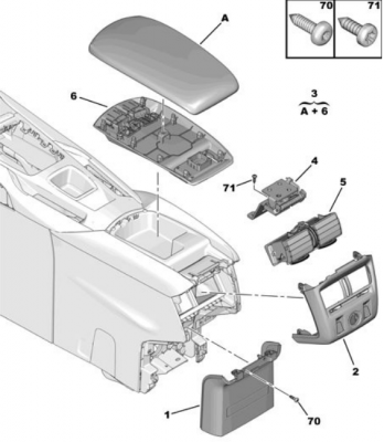

It's just a plug module - but you'll need a converter for the voltage as USB is 5V. The rear trim comes off with simple trim removal tools. (5) is the power lead for accessories and (6) is the 12V Lighter.
