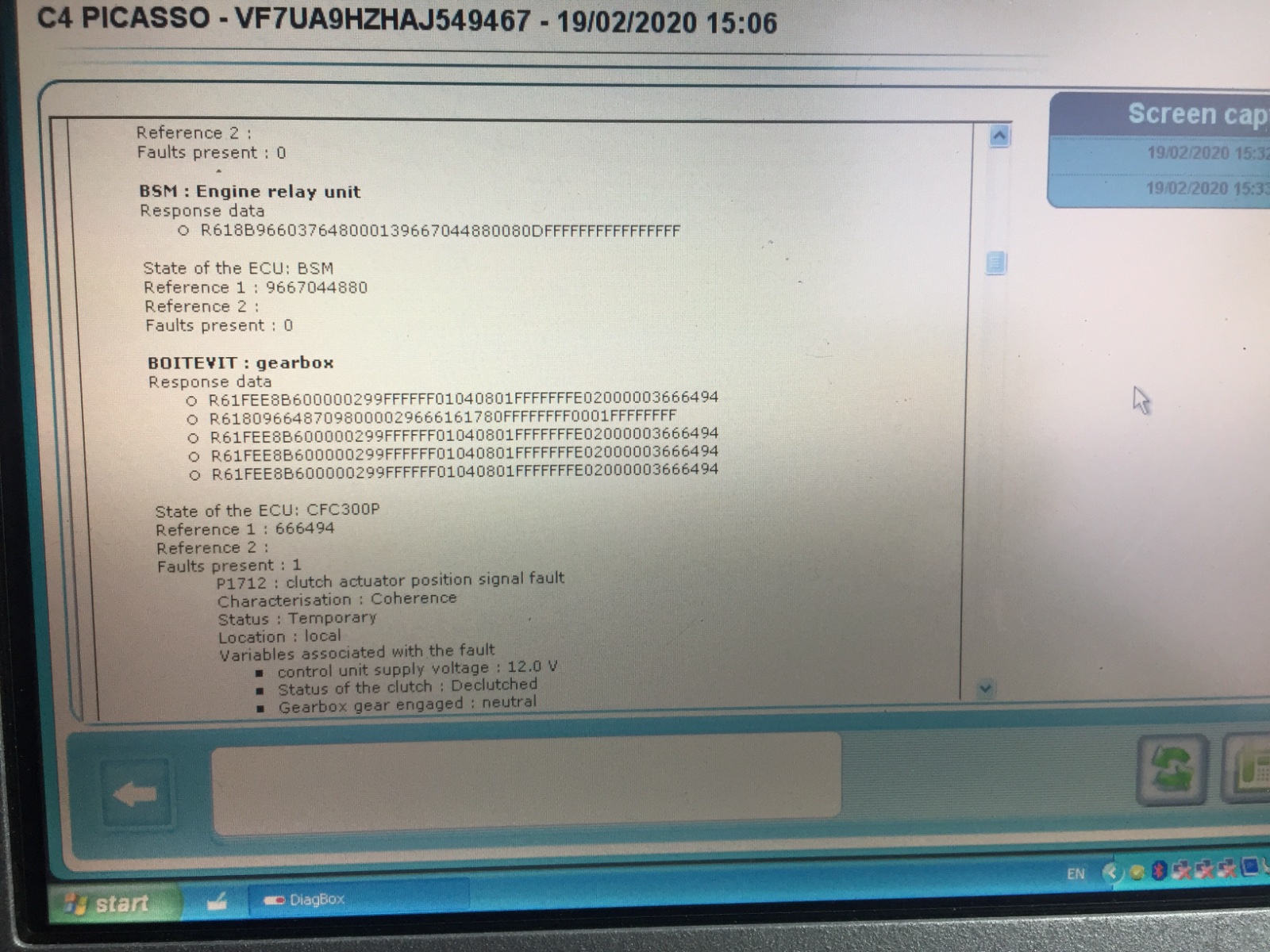

Anyone tell me what this live data means please
Benscab123
Posts: 158
Joined: 09 Jul 2019, 20:33
x 3
Unread post by Benscab123 »
Could someone please tell me what this diagbox data means please. Trying to see why I’m getting turbo underboost. Thanks.
