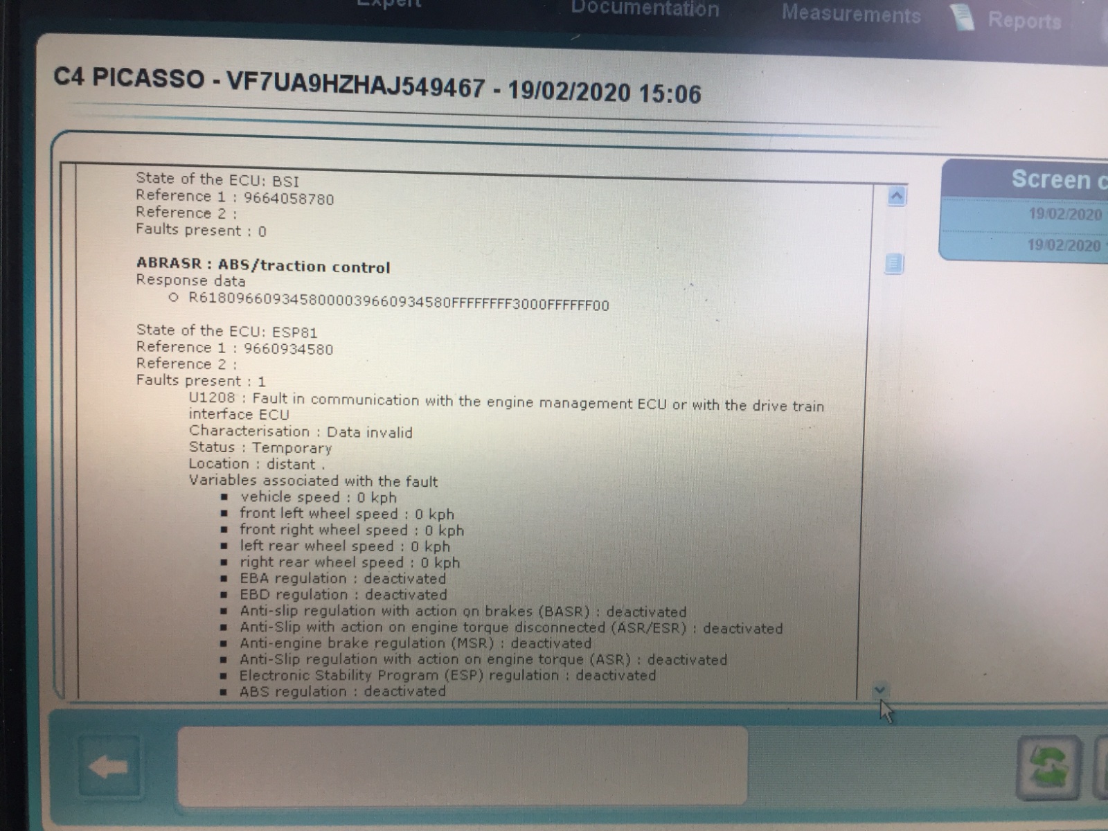

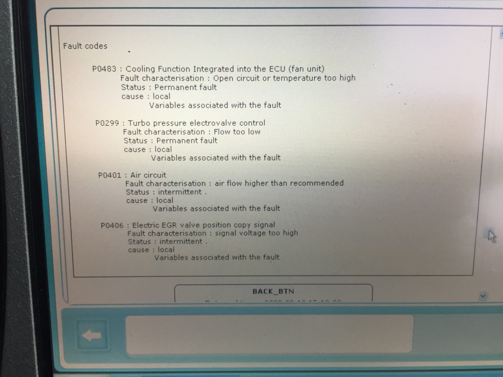

Anyone tell me what this live data means please
Benscab123
- Posts: 158
- Joined: 09 Jul 2019, 20:33
- x 3
Could someone please tell me what this diagbox data means please. Trying to see why I’m getting turbo underboost. Thanks.

Re: Anyone tell me what this live data means please
I'd check the vakuum lines for the turbo electrovalve, and if they're fine i would change the electrovalve. It is a common fault on these.
