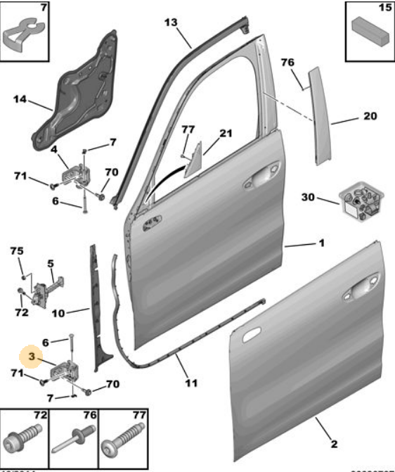

I need to know the part no. Of the car door lift as it makes noise in closing and opening the doors it is one at each door for car Citroen C4 Grand Picasso 2015 new shape

What are you referring to? The hinge (item 3)?
Generally, just lubricating these with some silicone oil spray and some marine grease would likely solve the issue.

I think the part is no.5 as the door is handeled by one upper and lower arms and the issue i face is with the black part in the middle of both and all lubricans doesnt work

Item 5 is 'DOOR STOP'
Often known as a door stay. It makes a 'clack' noise when door is fully opened, and stops it swinging shut.
The mechanism can wear, and need replacing.
Front doors, L&R: 96 763 451 80
Rear doors, L&R: 96 761 173 80
