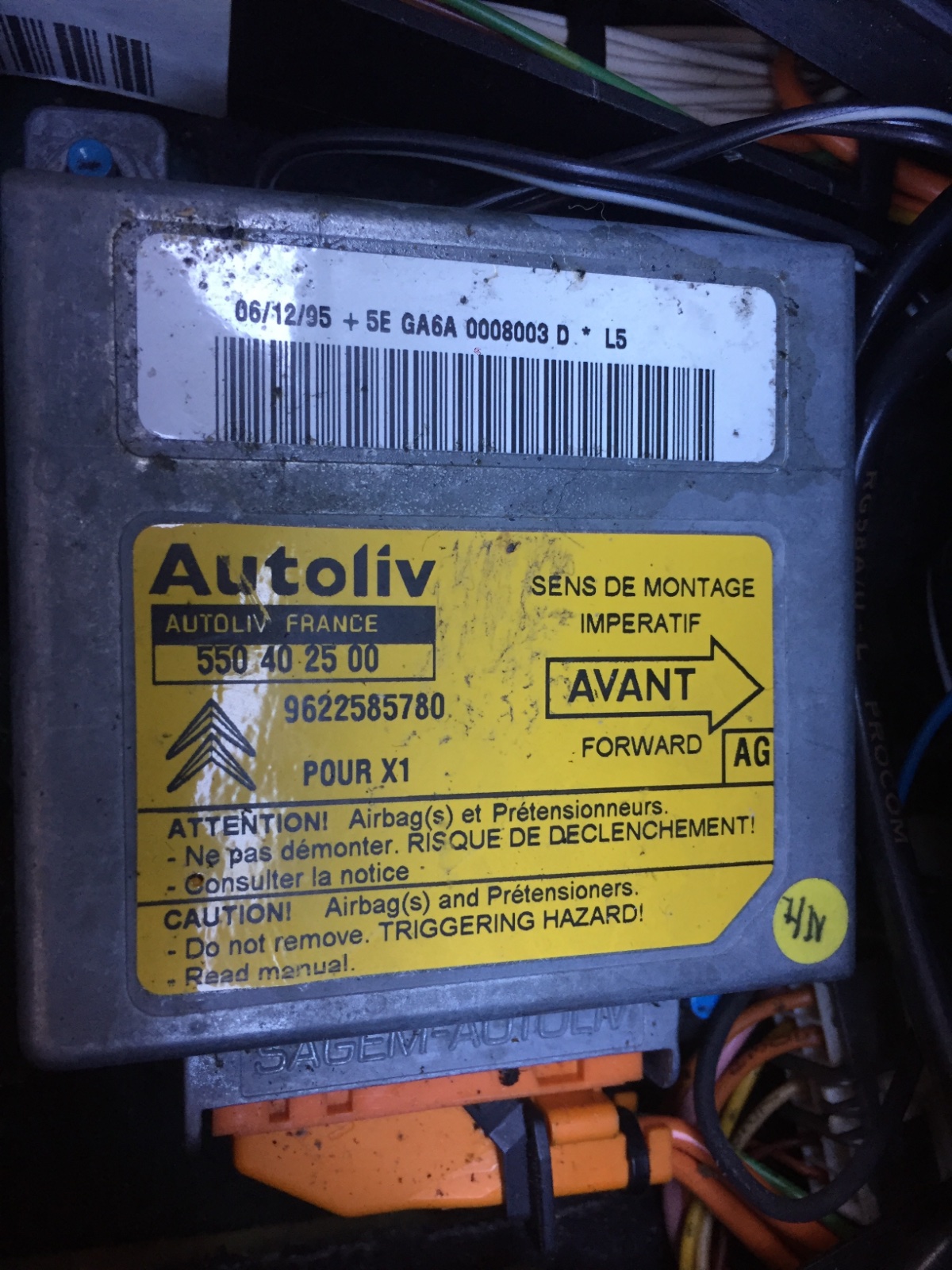

Having looked, I find the part numbers somewhat confusing for the airbag ECU.
Eg. mine has; 550 40 25 00, 9622585780 for X1 on the yellow label but also has a white lace with barcode and 06/12/95 + 5E GA6A 0008003 D * L5.
There are many used controllers on eBay etc that all look the same but have different sets of numbers on the yellow label... Mostly for X2.
Are these universal or model specific?
Diagnostic booked this pm at Citroen dealer...
Thank you again...

Xantia mk1 Airbag ECU/Control unit
I was posting on a different thread whilst trying to locate my airbag warning light fault.
My airbag system was scanned by a citroen dealer and the the airbag ECU/control unit is faulty. Citroen tell me that these units are no longer made for this car.
I am ignorant when it comes to the Xantia's electronic control systems.
There are many used ECU's for Xantia's on eBay with differing numbers etc.
Are these ECU's model specific and do the need coding? Can I just fit a tested module in place of the faulty one?
My original thread with a photo of my existing ECU and car details is here: viewtopic.php?p=636186#p636186
Thank you in advance...
