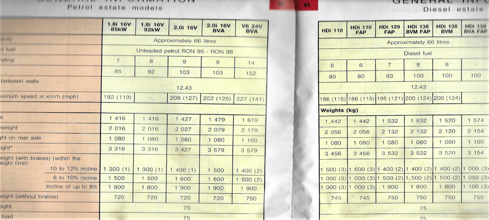

- x 2941
Re: Max. weight for back axle on C5 estate.
This help?
