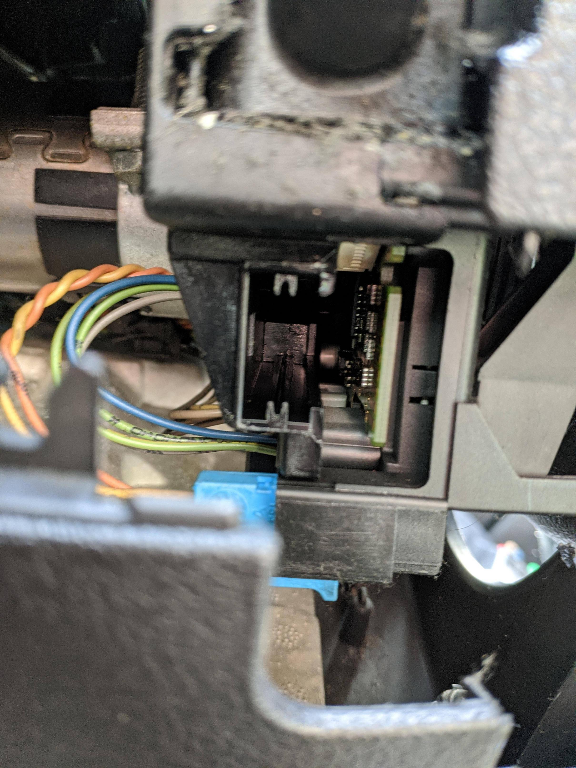

I have read on some forums that its possible to add cruise control option on this car,It needs just cruise control switch.This is what I have bellow steering wheel.
x 6963
Re: 307 1.6 HDi install cruise control
You'll need a clutch switch, the double brake light switch (if not fitted) the stalk and it will need the option coding using Peugeot Planet 2000 / Diagbox if your engine ECU supports it.

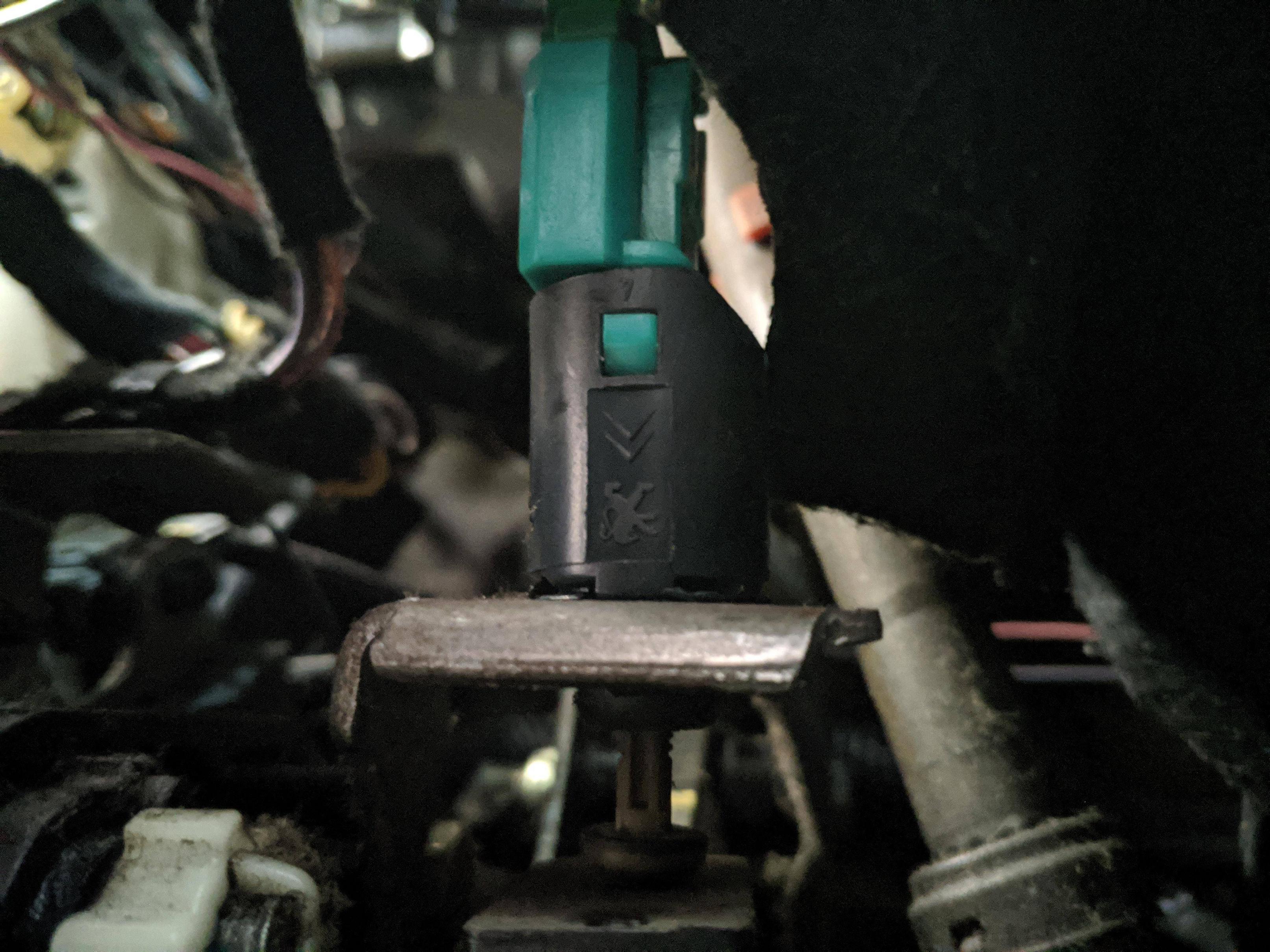

Thats the only switch i have green one on brake
x 6963
I've had a quick look and it seems you have the switches.
