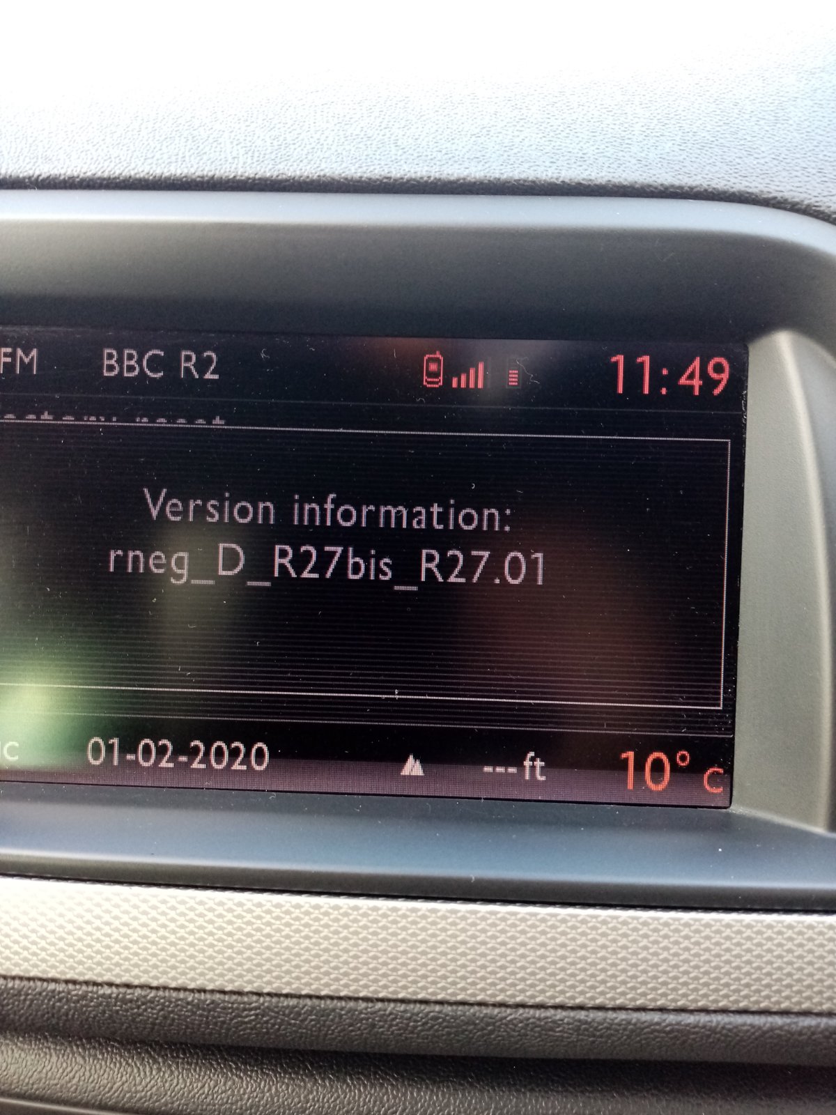

Please see photograph of firmware
How do I update the firmware?

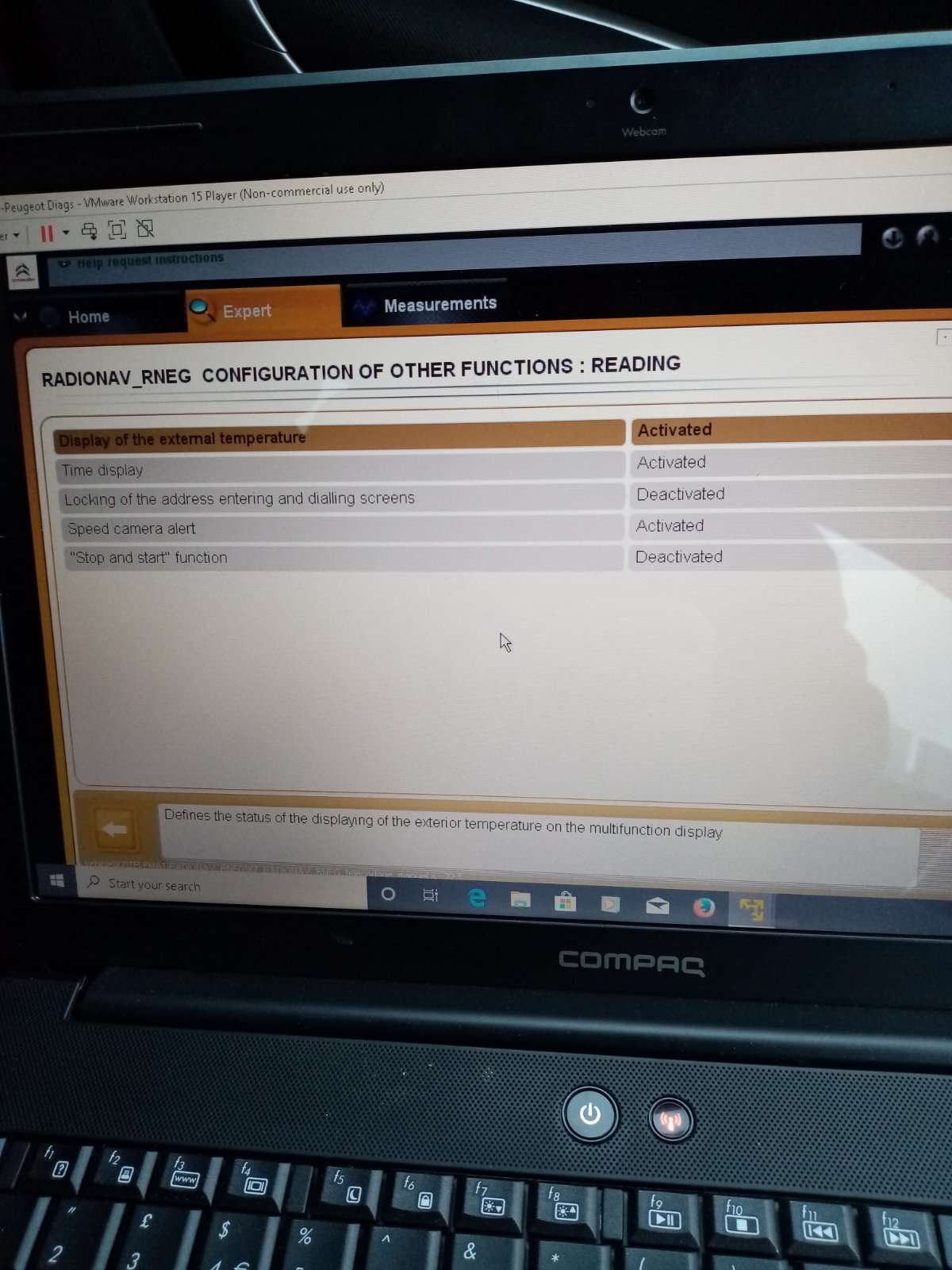

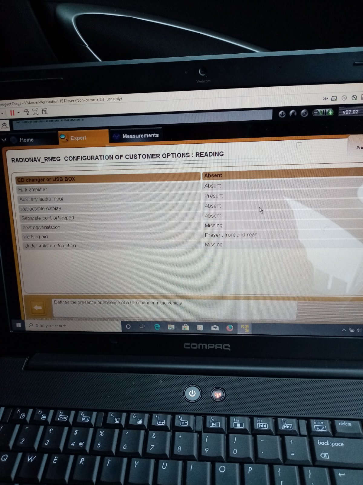

Re: Update
Unread post by Steveo »

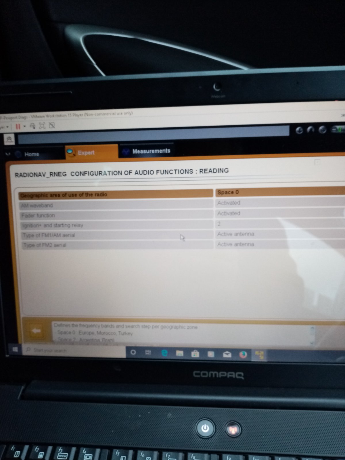

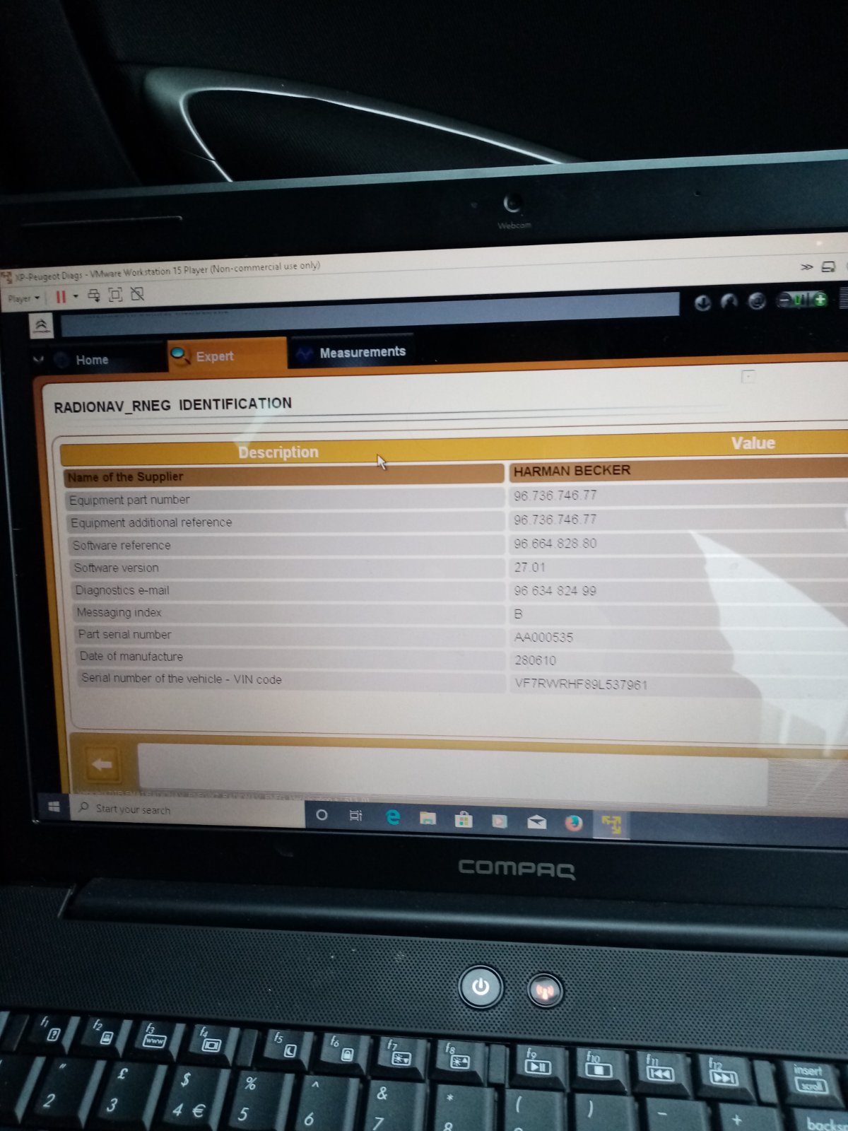

Hi Marc
Is this what you need
Regards
Steve
PS
Sorry about the quality

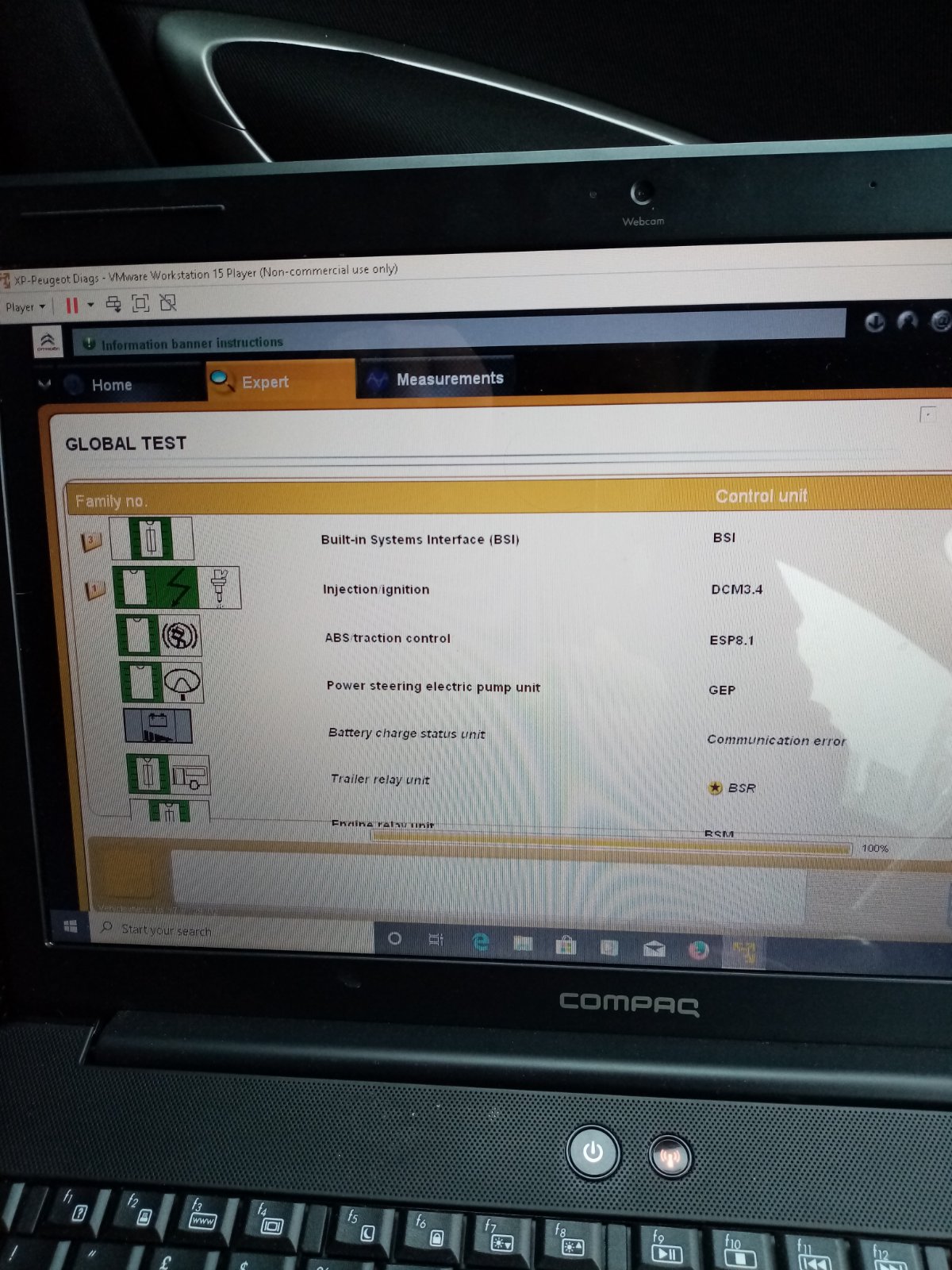

x 6955
Re: Update
Ok, thanks Steve - I will look at these and be in touch - just have a couple of things to do here then I'll get onto it.
x 6955
Re: Update

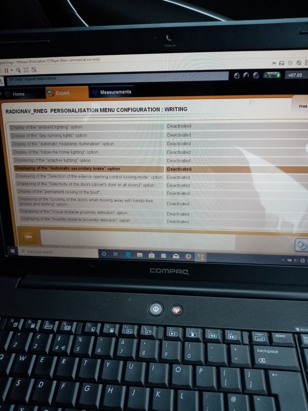

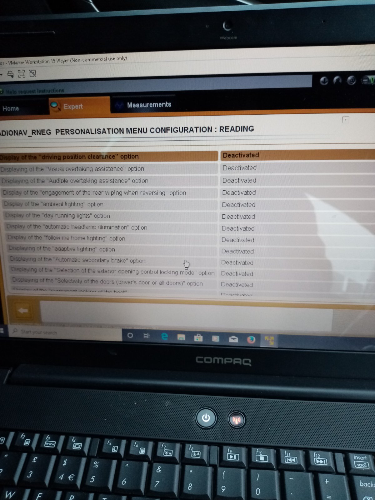

Ok, so you need to change the following: For items listed as 'Missing' on your screen shots (Heating Ventilation / Under Inflation Detection), see if you can change these to 'Absent'. Otherwise the BSI may be expecting them if previously configured for the donor vehicle in the Head Unit ECU - where they are not valid on your C5.
  • Parking Aid to Absent
  • Under Inflation Detection to Absent
  • Heating Ventilation to Absent
In your screenshots above, there are 2 pictures that show a list of options as all 'Deactivated' - these are correct and must not be changed. It does not mean that any applicable items are missing - it actually only means how the data is routed and how the displays of the data for these option (if present) are handled on the vehicle with a telematics system. They must be left as deactivated.
That's all the options correct for what you have shown me.
There are some BSI errors showing, so when you have coded the parameters I listed above, (select option, then green tick, then from following menu select appropriate option, then press cog wheel to code it), - re-run the global test and let me know all the fault codes shown (see if the BSI ones are still there) and if so, what they are - along with anything else.
