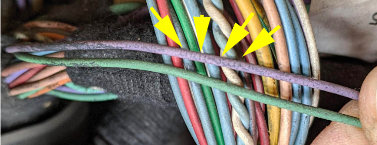

Tnx for answer.I have found this cable isnt connected anywhere.How to know for what purpose is?
- x 6945
Re: 307 1.6 hdi disable chinese alarm
Have a look on the green and purple wires - along the sleeve - can you see any numbers? The wires usually have some codes to identify them. You may need to look quite a way up the wire along both sides. That might help us.
Ok, so in the snip below, can you gently clean the oil off as that looks like there may be some writing / codes on the wire where I have arrowed in yellow. I can't read it as there is too much dirt!
I have tried that but letters seems that are faded away
- x 6945
Ok, it is usually the numbers and a letter - but the sequence is repeated on the wiring sleeve - so you may find a clean spot under the black insulation further up. Without this it will be very hard to identify - and even then there are no guarantees. Have a look under the black masking tape a little further if you can.
Ok,I have followed wires to the end and here are numbers on it
Purple 723766 1710
Green 723766 1410
Purple 723766 1710
Green 723766 1410
- x 6945
I'm not having any luck to be honest - the only codes I can locate for the last 4 numbers are:
1410: turbocharging solenoid valve earth 2
1710: electric cooling coolant pump supply
But I can't actually tie 1710 back to anything on your vehicle, only 1410a and 1410b which are the earths to the tubocharging solenoid valve (s).
