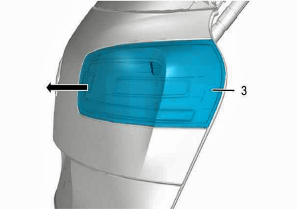

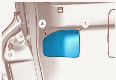

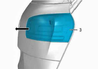

You'll need some trim removal tools to help. They recommend disconnecting the battery first (follow this guide BSI Reset / Battery Disconnect / Reconnect Procedure)
Removal
| Unclip the cover (1) ( at "a") using trim tools. Remove the cover (1). | Remove the bolts (2). Disconnect the connector (at "b"). Unclip the tail lamp (3) (at "c"). Detach the rear lamp unit (3). |
| Remove the rear lamp (3) (In the direction of the arrow ). |
Proceed in the reverse order to removal.
Reconnect the ancillaries battery (refer to reconnection part of previous procedure).
Check the operation of the equipment.
