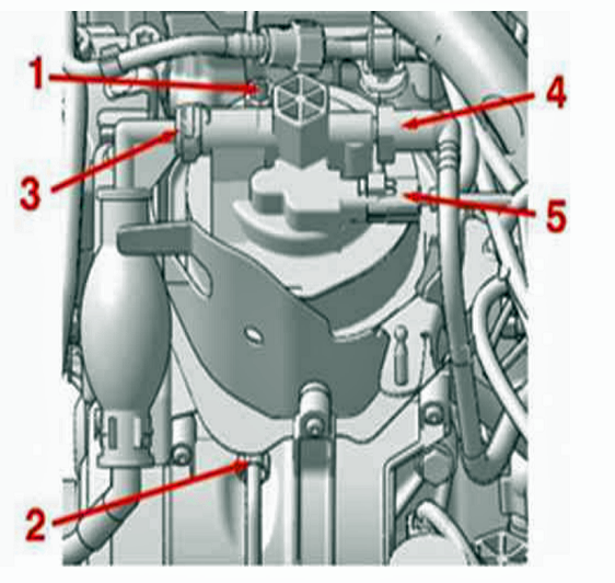

Ok, here you are:
Peugeot (407 - Specific DW10BTED4) Fuel Filter Replacement Proedure
Note: This is for the specific model above - later DW10BTED4 engines have a different procedure
Removing
Note: After the ignition has been switched off, wait 15 minutes before disconnecting the battery (To ensure that the learning patterns of the various ECUs are stored in memory) .
Disconnect the battery following the (BSI Reset / Battery Disconnect / Reconnect Procedure)
  • Remove the engine style cover.
  • Remove the shield under the engine.
  • Place a draining tray under the engine.
  • Drain the filter.
Open:
  • The breather bolt (1)
  • The drain screw (2)
Disconnect:
  • The fuel connectors (3 - 4)
  • The connector for the heating element (5)
Pour the degreasing agent into a container (According to equipment)
ESSENTIAL: Cover the fuel connectors with covers supplied in the filter kit .
Unscrew:
  • The cover (6)
  • The (7) bolt
Remove the screws (8).
Slacken the bolt (9).

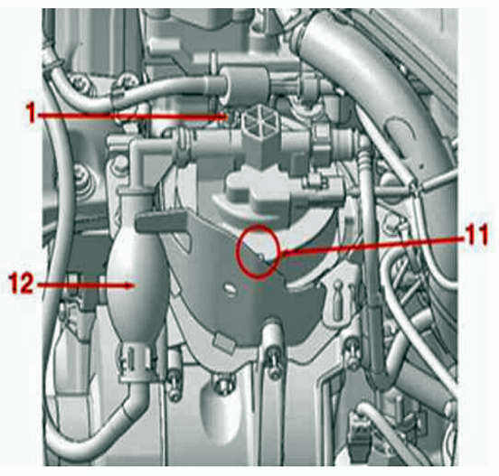

  • Tighten the cover until it is in contact with the bowl (11).
  • Bleed the bowl with the breather (1) and the bulb (12).
  • Operate the bulb to rinse the reservoir.
