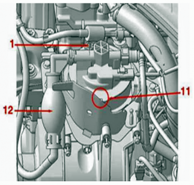

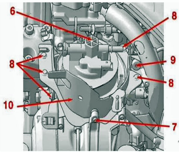

Ok, here you are:
Peugeot (407 - Specific DW10BTED4) Fuel Filter Replacement Proedure
Note: This is for the specific model above - later DW10BTED4 engines have a different procedure
Removing
Note: After the ignition has been switched off, wait 15 minutes before disconnecting the battery (To ensure that the learning patterns of the various ECUs are stored in memory) .
Disconnect the battery following the (BSI Reset / Battery Disconnect / Reconnect Procedure)
Refitting
ESSENTIAL: Open the sachet containing the new filter element just before refitting.
Refit:
Removing
- Remove the engine style cover.
- Remove the shield under the engine.
- Place a draining tray under the engine.
- Drain the filter.
Open:
ESSENTIAL: Cover the fuel connectors with covers supplied in the filter kit . | Unscrew:
Slacken the bolt (9). Remove:
Clean the fuel filter bowl using a brush and degreasing agent SODIMAC 35. Before refitting, allow the fuel filter bowl to drip. CAUTION: Do not use compressed air. Tighten the drain screw of the float chamber. CAUTION: Mounting of the diesel filter assembly on a vice is strictly prohibited. |
Refitting
Refit:
- The fuel filter bowl on its support (Tighten the bolts (8 - 9) to 1.0 m.daN )
- The new filter element
- A new seal
- The cover
- The fuel pipes (3)
- The connector for the heating element (5)
