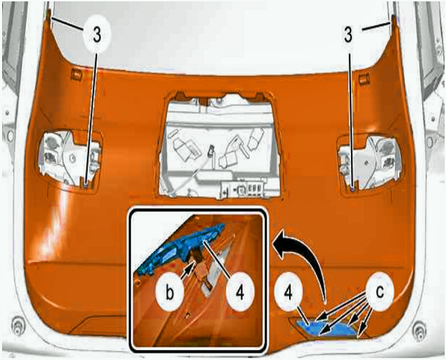

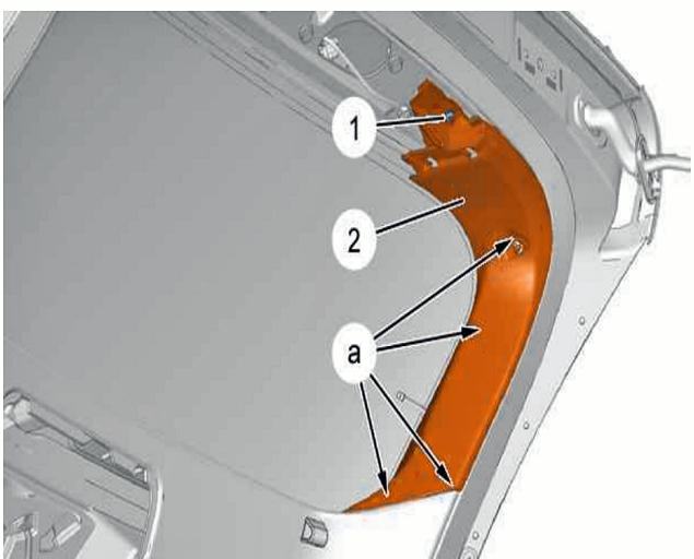

Exbt95 wrote: 21 Jan 2020, 22:38 Evening Marc, sorry for the late reply, my vin No is,
VF7**************[VIN obfuscated, can be read by forum staff]. Thanks. Mick.
Ok, so this should be the relevant part Mick:
Symmetrical operations :
Remove the bolt (1)
Unclip the trim (2) (at "a") using trim removal tools
Remove the trim (2)
Remove the bolts (3).
Unclip the trim (4) (at "c") using trim removal tools.
Release the trim (4).
Disconnect the connector (at "b").
Remove the trim (4).

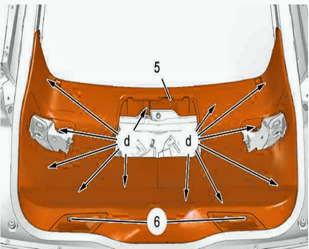

emove the bolts (6).
Unclip the trim (5) ( as "d") using trim removal tools.
Remove:
The trim (5)
