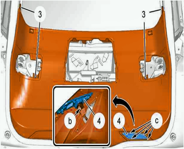

Re: C4 reversing camera
Ok, so this should be the relevant part Mick:Exbt95 wrote: 21 Jan 2020, 22:38 Evening Marc, sorry for the late reply, my vin No is,
VF7**************[VIN obfuscated, can be read by forum staff]. Thanks. Mick.
| Symmetrical operations : Remove the bolt (1) Unclip the trim (2) (at "a") using trim removal tools Remove the trim (2) | Remove the bolts (3). Unclip the trim (4) (at "c") using trim removal tools. Release the trim (4). Disconnect the connector (at "b"). Remove the trim (4). |
| emove the bolts (6). Unclip the trim (5) ( as "d") using trim removal tools. Remove: The trim (5) |
Hi Marc,
I need to remove the tailgate lower trim panel of my C4 Grand Picasso to fit a replacement reversing camera. Would you be able to post up instructions like these for my vehicle?
2015 Citroen C4 Grand Picasso Exclusive

Apologies for the thread of questions:
I don’t have access to the bolt (1) in the first instruction (top left image). There’s a plastic panel above the rear window covering that area. Does that panel just pop off? Or are there further instructions on how to take that panel off?
Many thanks!
Shane
I managed to pop that panel off as it didn’t seem to have any screws or rivets when looking at the part image. Just clipped in. All good.
- x 6955
Just seen this, and I was going to say it just clips off using some trim removal tools, but you've sorted it now.
