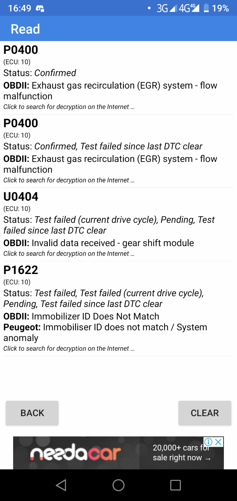

Since then, I borrowed and ran a diagnostics using one of those cheap obd2 with an app on my phone, and got these faults (I actually ran it before taking the battery out too, before I was getting the economy mode and got the same errors but without the p1622 fault).
I'm not sure if it's not starting because of the key, or because it's in economy mode, or if it's because I might have been using a battery who was lacking the volts despite being fully charged, or what. I'm just reading random forums getting confused at this point.

@xantia_v6 I never transferred the chip no. I'll check whether the light comes on next time I start it. I'll also get the VIN too. Thanks for the help.
I'm getting that P1622 fault and "Immobiliser ID Does Not Match" message because the key isn't sending a security code because it hasn't been programmed, is that right? (I'm just getting my head around all this, I've been rather confused about it)

Re: Peugot 307 SW - Fix it or scrap it?
If you have a key that has not been coded to the car, then there are two methods.
1. You can transfer the tranponder chip from your old key
2.. You can use the Diagbox configuration tool to program the key (but you need the confidential programing PIN code for the car)
3. A locksmith with the right tool can clone the transponder from another key that is programmed to the car (but you have to have a key with working transponder). That will cost you about NZ$100
Your best course of action depends on whether your original key has a removable transponder chip.

Agh i do hope you still have the original broken fob, really feel this is going to be (the immobiliser part at least) down to the correct transponder chip not being in the new fob. They're not the same as the circuit board, that's a "plip" for the locking/alarm, if it had a transponder then it'll probably be a small black chip that's clipped into the plastic case of the fob.
Was quite a common thing for people to replace 206 key fobs because of broken buttons & accidentally throw away the transponder with the old one. Fingers crossed you can sort that part, the rest is/was likely down to an ailing battery with any luck.

I've lost the transponder/body part of my key fob unfortunately, so only have the blade. It wasn't a removal one anyway as far as I can remember.
It sounds like I'll need to get the replacement key I ordered programed, which means I'll need the pin to get into the ecu (from what I've read) which is what I'm trying to figure out how to get now. I was going to order an lexia3 cable and download the pp2000 software and try program it that way/get a better diagnostics to go off. Does that sound like the right approach?.. I would consider just paying to have a new key programmed if not for the usefulness of being able to use the pp2000 software.

You will need the confidential customer code to programme any new fob, and will also need to programme all existing fobs you intend to use with the vehicle again in the same session. Not doing so will lock out any fob not included.
If you don't have your confidential code (usually contained on a credit card sized key card), then you can obtain it from Peugeot, for a fee of about £20-25, along with proof of vehicle ownership, identification and something with your address on.
