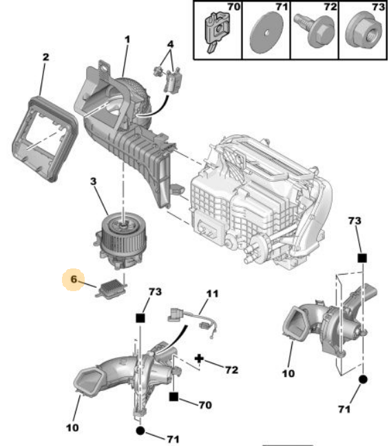

Ok, on your 5008, you have the Automatic A/C control with additional blower for the rear.
The Heater Control module is item (6), part number: 6441CQ and costs £153.20 from Peugeot.

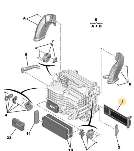

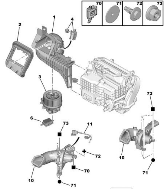

Are you sure you are looking at the correct part? That sounds like you have been looking at the Heating resistance unit which is on the Driver side, not the Blower Control Module that would appear to be on the left next to the Blower motor?.....
This is the heating resistance (1): on the right hand side:
Blower module control (4) on the left.....
This looks a completely different setup to any of the C4 Picassos too.

Re: Peugeot 5008 Fans intermittent / not working
It was number 6 that i tried replacing but to no avail. I might be using the wrong words for what I'm describing i do apologise. The thick cable that goes into number 3 is where i was getting a 14.25v reading from. I checked that when the blower motor had died off. I shall try 12v directly into the motor and see what happens. After finding a feather wedged in the number 3 part, i dread to think what else is in there. I have a 2nd hand no3 part coming this week.
