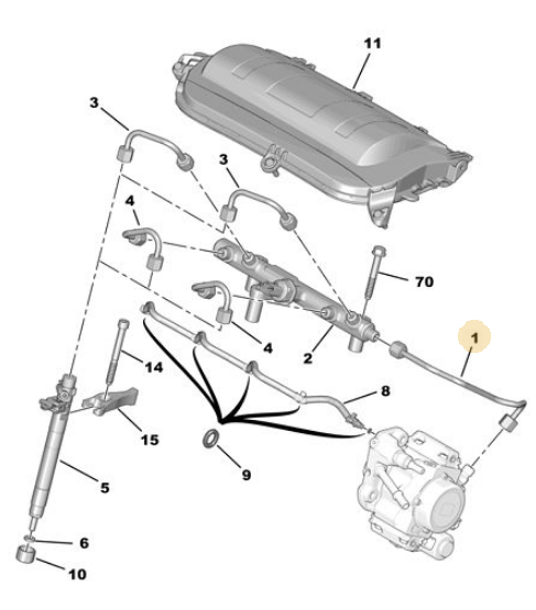

- x 6961
Re: C5 X7 won't start
Hi Adrianadrianruk wrote: 11 Aug 2020, 11:54 Right 3 new sets of injector clamps, bolts & seals fitted. Struggling to get the rail to injector pipes to seal now. Citroen advise replacing them each time I believe. These have been on & off a few times now. I'm afraid of over-tightening them. Any idea of part numbers of new ones?
TIA
Adrian
PS Mercedes E250 CDI estate is settling in!
Ok, so the pipes are as follows:
Item (4) Part: 1570P4 £33.22 Each
Item (3) Part: 1570P5 £32.68 Each
All VAT inclusive.
Any other parts let me know.
