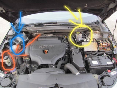

Hi guys, first off merry xmas when it comes and happy new year too all..... can anyone help me by telling me what this is.... (not my pic) the orange arrow. Thanks in advance.

Orange circled thing is the power steering reservoir.

Ah i thought it was, but was not sure as i know where coolant and brake fluid go but i was like mmmmmm what is that lol. Thanks mate 👍🏻

If it's on your C5 (X7) then it should be topped up with Total Fluide DA or Total LDS (they're both the same thing). It should NOT be topped up with a generic power steering fluid or Citroen LHM fluid.

Your fuse box next the battery is missing its cover. Get one asap otherwise your car will literally go pop as water seeps in and starts to cause a considerable amount of havoc!
