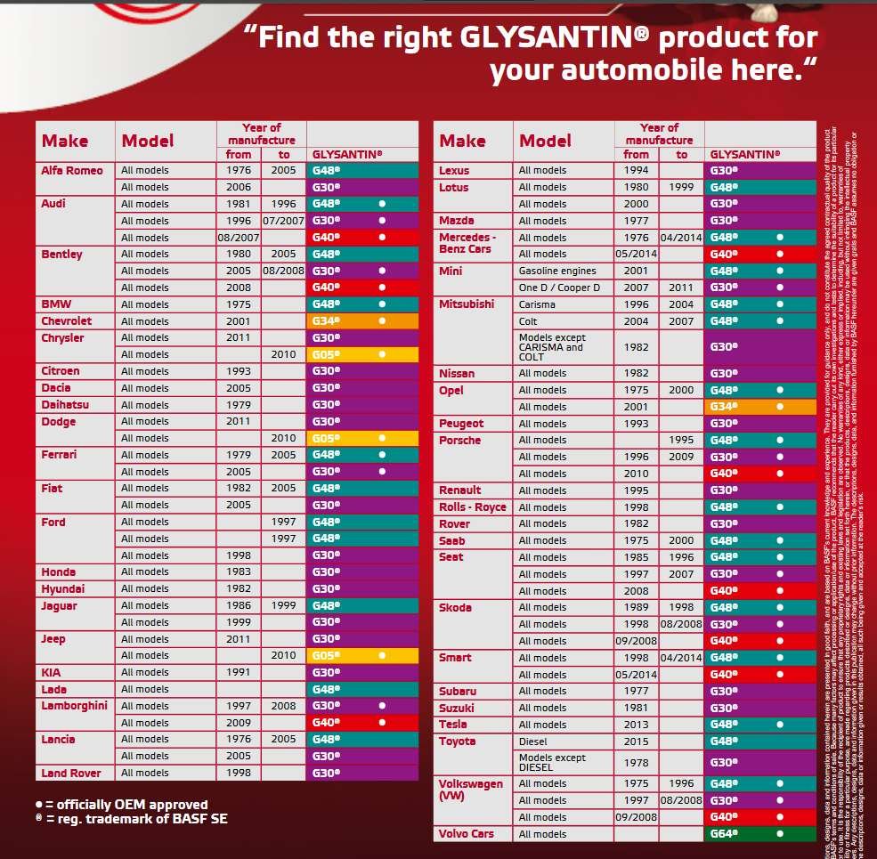

Even BASF, the makers of Glysantin, say that G30 is the right antifreeze for Citroens....
https://www.glysantin.de/sites/default/ ... ars_EN.pdf?
https://www.glysantin.de/en

Sounds suspiciously like the Citroen Antigel I have been using.
