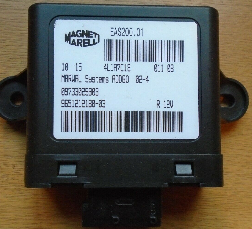

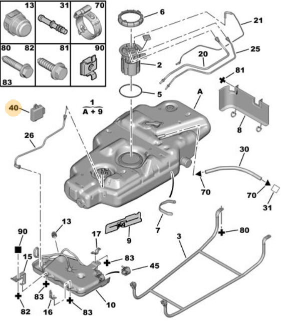

Ok, so that is well past the top up point - and I would suspect that it has been topped up already at some point - but may be due for another top up.
The Additive system on your C8 is of the older type and has a separate Additive ECU. On newer vehicles, this function is managed by the Engine ECU directly. In the early days - these ECUs were notorious for refusing to be reset by the diagnostic equipment after the additive level was topped up. Consequently they were constantly throwing up errors. The know solution was to replace the additive ECU. It's a Marwal unit.
Part no: 1525CZ for reference.
Item 40 on the diagram:
So that may be one reason why you are getting warnings - either the ECU has not been reset and thinks there is insufficient additive in the tank (it is not physically measured with a gauge - only estimated from the top up and reset against the mileage and fuel added).
