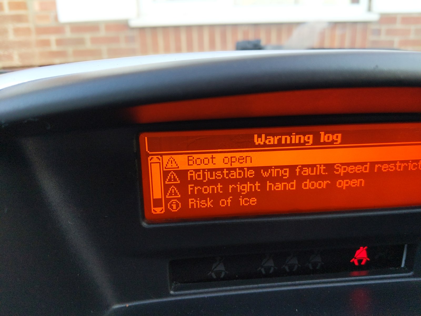

Hello all, not sure if this is normal but had my boot open earlier but when switching on engine I had the following errors come up
Boot open
Adjustable wing speed restricted (see manual)
Is this normal or is it something more serious many thanks. Sorry
I have a Peugeot 207 sport vti
- x 6945

Re: Adjustable wing speed restricted
Hi yes I'm sure that what it said I will take a photo tomorrow and post it, I found it strange too thanks for your reply.

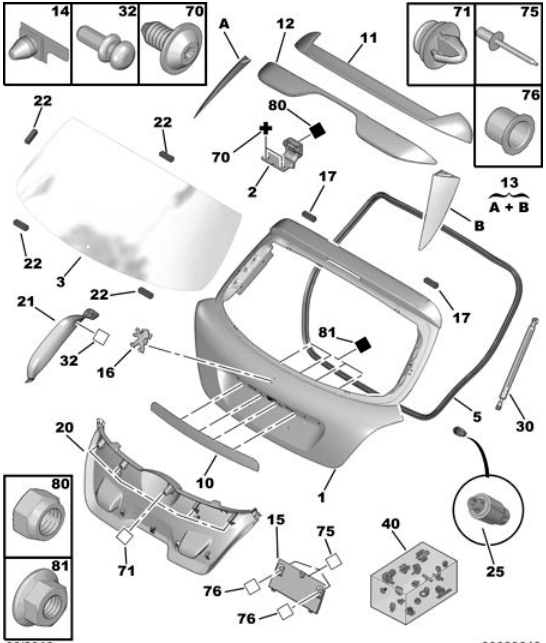

Confirmed - this is a 2010 207 3 DOOR SALOON 1.6 VTi 16v 120 (EP6C) 4-SPEED AUTOMATIC GEARBOX
The only spoilers fitted were shown below as items 11 or 12 - but none of these were fitted to this secific vehicle and in either case none were motorised / speed sensitive.
So I think you will have to get it diagnosed by somebody with Diagbox and let us have the fault codes as either you have an electrical issue, or something may have been mis-configured in the BSI at some point.
