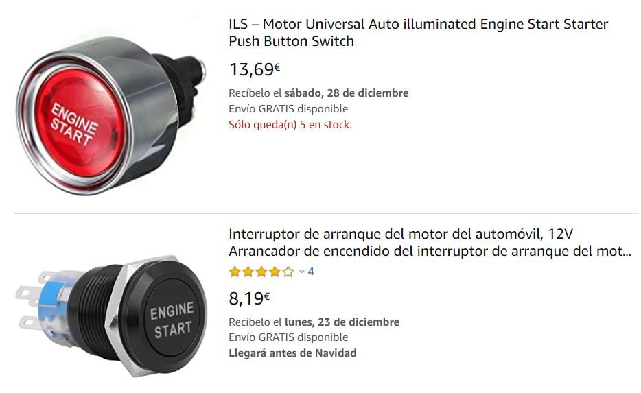

If the IGN switch proves impossible to remove (some are very difficult), one modification alternative is to allow the IGN switch to turn the IGN on (as normal), but to fit a 'push-to-start' button somewhere convenient on the dash. This would simply route batt+ to the small terminal on the starter motor. You could also add a 30/40A relay to take the load off the switch.
A couple of nice-looking engine start switches on Amazon.es ...
