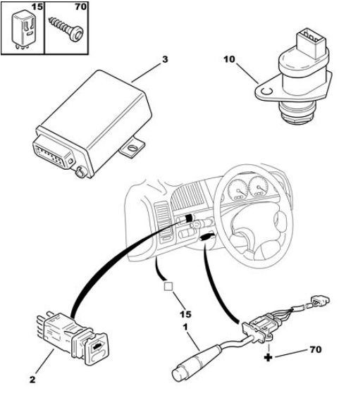

Re: Xantia Help required please!
This is the module (item 3) on a late Xantia that you need to have too that I referred to:

Unread post by RichardW »
Not needed on an HDi Marc - as Mike says the cruise function is built into the ECU. First thing to check for the OP is the ECU with Lexia / Diagbox to see if there is an option for RVV (I think, French for cruise). If it's not, then a new matched ECU and CPH body computer will be required first. I supplied the one Paul used off my scrap 2001 HDi.
