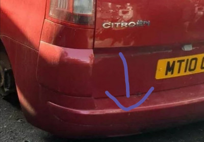

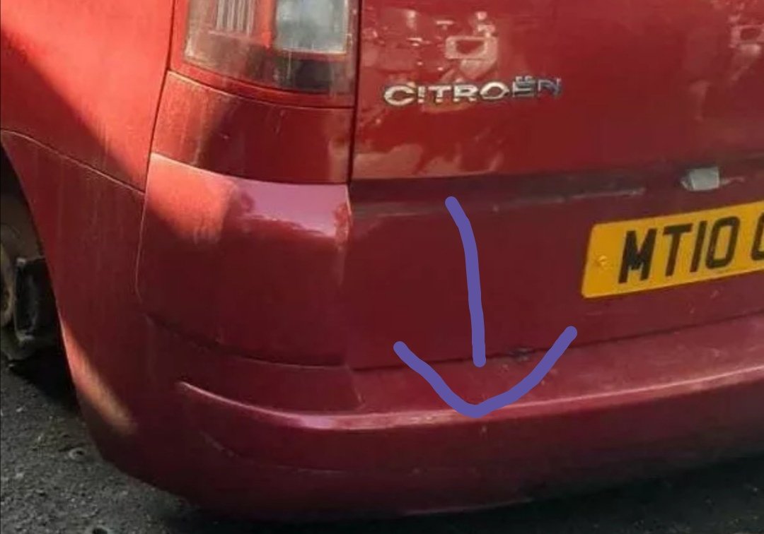

Hi All
Am I right in thinking this trim comes away from the main bumper? If so does it come away without removing the entire rear bumper first? Also does this section from a C4 Picasso also fit or is the Grand Picasso unique? Thanks

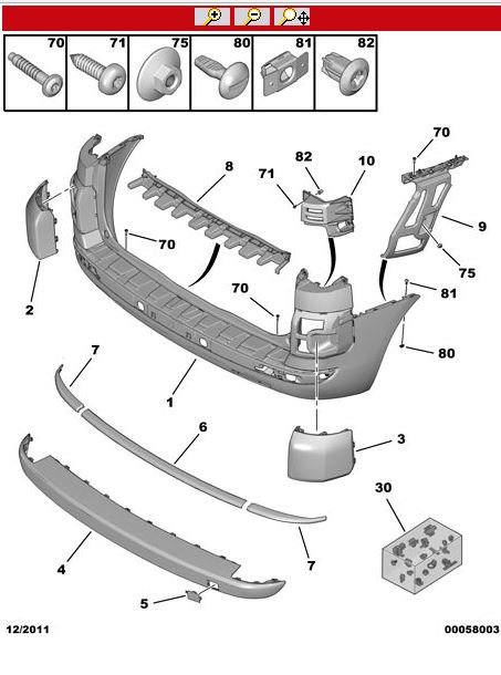

Looks like it 'just' clips in as no bolts are shown. I suspect it will be necessary to remove the bumper to free the clips without destroying it. Different part numbers on the normal Picasso.

This is perfect thanks so much. Its given me the info to pull off. Just pulled off, clips survived but the corner ripped which is fine as removing to replace...... Well once I find one, they are like hens teeth
