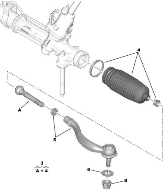

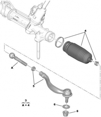

Re: C5 X7 Steering rack gaiter.
Adrian,
Why not try these ones ?
Sorry about the other post
Kenny
Kenny
