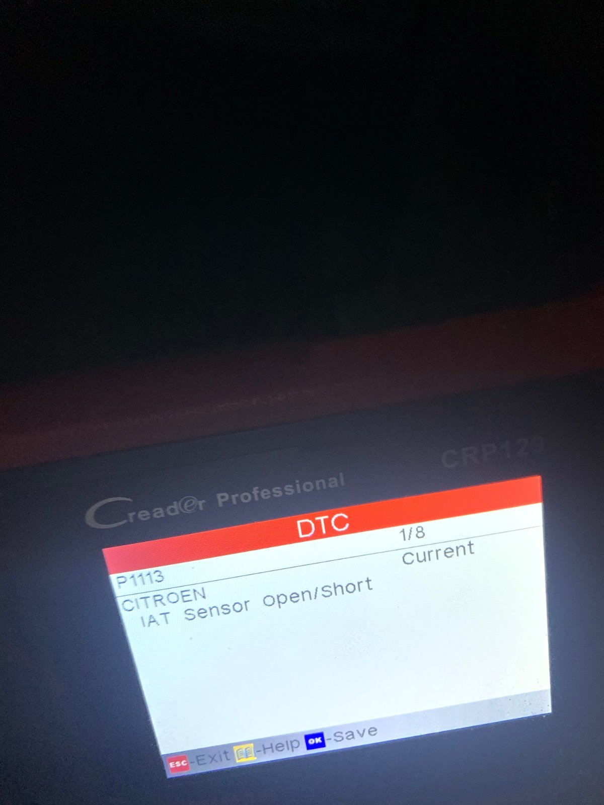

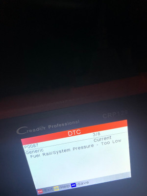

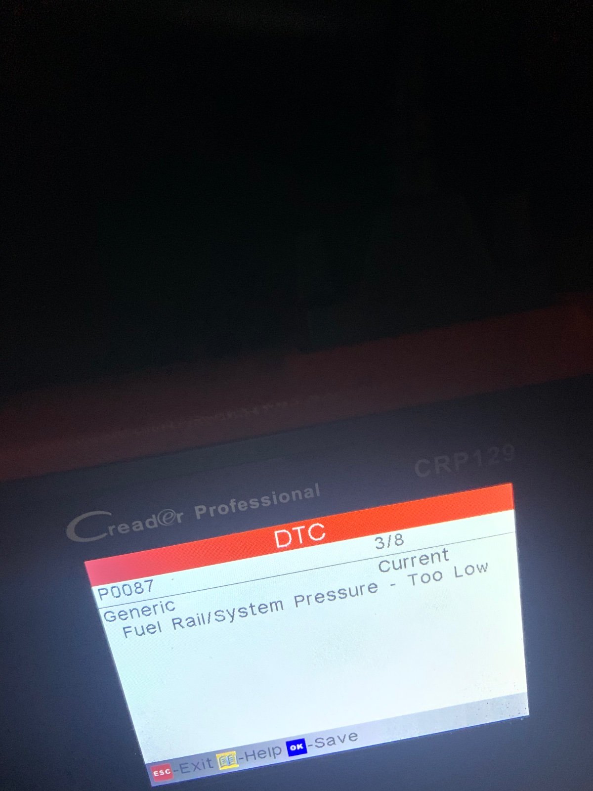

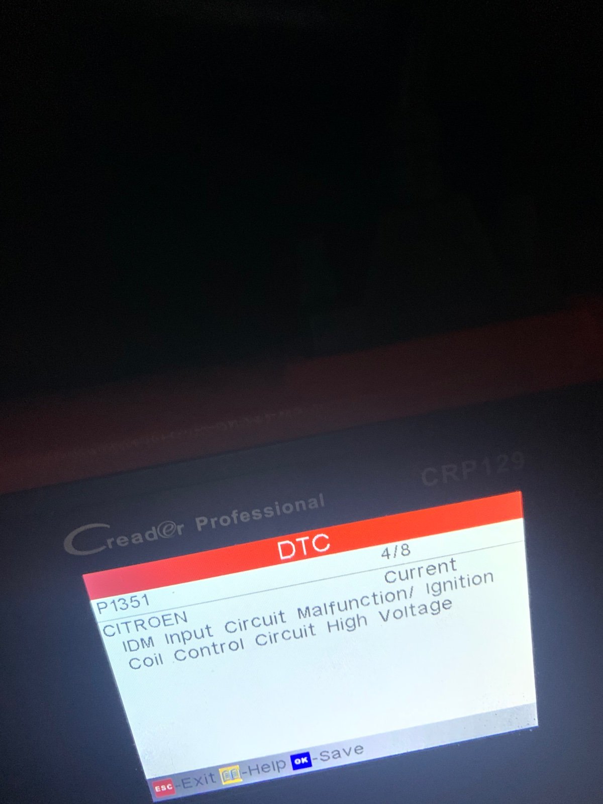

Have a Citroen dispatch van 1.6 hdi been having problems with anti pullution light coming on and stalling while in traffic. Have replaced fuel rail pressure sensor few months back it helped for awhile but has came back with vengeance’s lol. Help guys. Pics of fault codes below

Ok, here we go...
Fault P1113: Intake air temperature signal (Air flow meter): Open circuit or short circuit to the plus. The voltage of the inlet air temperature sensor signal is higher than 4.75V for more than 500 milliseconds.
Fault will disappear within 5 minutes of driving.
Downgrade Modes Activated:
Symptoms: Hesitation, Engine Cutting Out
Suspect Areas:
Description:
Description:
I would ignore this one for the moment - very common in most HDi engines - it just means the glow plug relay is supplied, but the glow plugs themselves are not.
This will likely mean you need one or more glow plugs.
- Deactivation of the coherence faults of the flowmeter
- Deactivation of the airflow faults above the minimum threshold
- Change to "easy move" torque invalid (Automatic handbrake)
Suspect Areas:
- Air temperature sensor on the flowmeter
- Electrical Harness
- Connector
- Engine Management ECU
Description:
- A fuel high pressure regulation fault has already been returned
- For an engine speed below 800 rpm: The difference between the measured rail pressure and the reference value of the fuel flow regulator is 350 bars for 900 milliseconds
- For an engine speed above 800 rpm: The difference between the measured rail pressure and the reference value of the fuel flow regulator is 200 bars for 900 milliseconds
- Engine stopped
- Irreversible cutting of the cruise control
- Deactivation of the automatic mode of the electrically controlled parking brake
- Deactivation of the speed limiter
- Engine hesitating, cutting out
- Diesel fuel consumption a bit higher
- Fluid leak/smells (diesel fuel, oil, etc.)
- Lack of power
- Starting problem
- Engine stopped
- Engine ECU (Software not up to date)
- Poor fuel or polluted fuel (petrol, deposit, etc.)
- Problem on the fuel low or high-speed circuit (hose, tank, diesel fuel filter, etc.)
- Fuel injectors
- Engine fuse box
- Electrical harness
- Fuel high pressure sensor
Description:
- For an engine speed below 800 rpm: The difference between the rail pressure measured and the rail pressure setting is 350 bars for 1200 ms.
- For an engine speed above 800 rpm: The difference between the rail pressure measured and the rail pressure setting is 200 bars for 1200 ms.
- Cut in the exhaust heat recovery function
- Cutting off of the cruise control function
- Deactivation of automatic mode for the electronic parking brake
- The ECU limits the fuel flow
- The activation of the regeneration of the particle emission filter
- Jerking/stalling
- Lack of power
- Starting problem
- Fuel injectors
- Engine fuse box
- Connectors
- High pressure fuel pump(Lack of pressure)
- Fuel pressure regulator (Lack of pressure)
- Fuel pressure sensor
