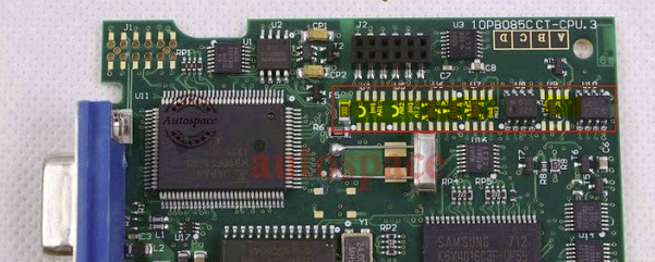

Any thoughts on this piece of kit, it says full chip.
https://www.ebay.co.uk/itm/Full-Chip-Le ... SwQ0Rc46~z
- x 6947
Re: Lexia Diagbox Queries
That’s not a full chip, if that’s a picture of the kit. Obvious to me it is missing half the components. If the price is too cheap then it probably isn’t the full ticket.
Anything less than £100 is suspect to be honest.

How do you know not full chip, same prices on aliexpress and in reviews they say it is full chip.GiveMeABreak wrote: 10 Nov 2019, 18:15 That’s not a full chip, if that’s a picture of the kit. Obvious to me it is missing half the components. If the price is too cheap then it probably isn’t the full ticket.
- x 6947
Because all the Optocouplers bar one are missing! I've highlighted the area in yellow where the chips are missing.
All these are cloned units of the original - but they are not all made equal and the cheaper ones invariably don't have all the components so don't work or can't read the ECUs of some full CAN vehicles.
It can be a bit of a minefield, as a lot of these are resellers of clones and don't really know what they are selling. Get one from a diagnostics dealer or one that states specifically that it works with the C5 / 308 as some indication. Your choice of course. UK suppliers are likely to offer a decent 12 month warranty and telephone support if you need it. You pay a bit more but have better piece of mind and are covered by distance selling regs and better consumer protections than you are buying from Asian market places such as you pointed to.
There is a discount available for FCF members from one UK supplier - we are not affiliated in any way, but your choice - I can only advise on what kits look dodgy from your links and my experience.
https://www.frenchcarforum.co.uk/forum/ ... hp?t=60112
Opto.png not showing as a photo Marc.

But that photo isn't included in the description of the reader in the link. I don't think that we can make the assumption that it will be like the photo you've posted.GiveMeABreak wrote: 11 Nov 2019, 09:39Because all the Optocouplers bar one are missing! I've highlighted the area in yellow where the chips are missing.
- x 6947
Yes it was Paul - I'm not making the assumption - I've looked at the photo supplied. It is the other way round (picture from seller site) and if you have the correct editing tools and zoom you can see they are missing.... I wouldn’t just post that without looking at the picture very closely!

Well I've been up and down the advert posted in the link and I can't see a photo of that side of that board. I remain confused on this one.
- x 6947
That's because the picture I posted is a stock photo I have of the same problem I'm forever talking about on these threads and posted it up to show just one example of the missing parts that do not appear to be in the photo of the board on the sellers link.
I already examined the seller's photo, magnified it up and concluded that the Optocoupler chips are missing. I don't always have the time to go into the 'nth' degree on everything, but as you are obviously curious, here is the seller's photo, cropped rotated to align with my picture and I have marked in yellow dots the missing Optocouplers and with red dots the 2 that in place also as per my other photo - typical of a cheaper clone.
You may not be able to zoom this up more as it has already been zoomed when I edited it.
OnlinePaul-R
- Posts: 9432
- x 1943
I thought that the photos were of the two opposite sides of the board? Is that not the case?
